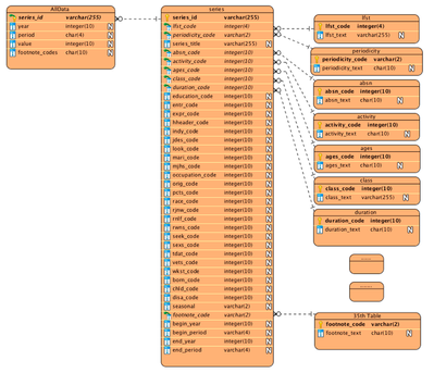

Case 1: Current Population Survey
Now let’s look at an example with Query Builder. The US government collects a lot of interesting data with the Current Population Survey (CPS)[USGCPS]. The CPS is:
The Current Population Survey (CPS) is one of the oldest, largest, and most well-recognized surveys in the United States. It is immensely important, providing information on many of the things that define us as individuals and as a society – our work, our earnings, and our education. In addition to being the primary source of monthly labor force statistics, the CPS is used to collect data for a variety of other studies that keep the nation informed of the economic and social well-being of its people. This is done by adding a set of supplemental questions to the monthly basic CPS questions. Supplemental inquiries vary month to month and cover a wide variety of topics such as child support, volunteerism, health insurance coverage, and school enrollment. Supplements are usually conducted annually or biannually, but the frequency and recurrence of a supplement depend completely on what best meets the needs of the supplement’s sponsor.”
These data are available to download as 36 text files, which are easily opened in JMP since the files are tab delimited text files. Looking at the JMP tables, an ER diagram (Figure 2) was created to inform the work in Query Builder.
Figure 2. ER diagram for the CPS labor force statistics data tables
To use Query Builder, you will need to define a Primary Table (fact) and Secondary Table(s) (dimension).
The fact table for the CPS data is called AllData.jmp. The table has more than 5 million rows but only five columns. The columns have a “series_id”, dates and a “value” column. To make any sense of the data, you need to find out what the series_id.jmp means. The ER diagram in Figure 2 shows that “series_id” is related to the series.jmp table. Next, open both those tables in JMP and use Query Builder define the join.
In JMP, select AllData.jmp as the Primary (fact) table and series.jmp as the Secondary (dimension) table (Figure 3). JMP will automatically look for keys that fit and set up the join, but you should verify it by clicking on the Venn diagram to the right of the series table. Query Builder found “footnote_codes” in both tables, but you do not want to join on those as key, just the “series_id,” so that key relationship should be removed.
