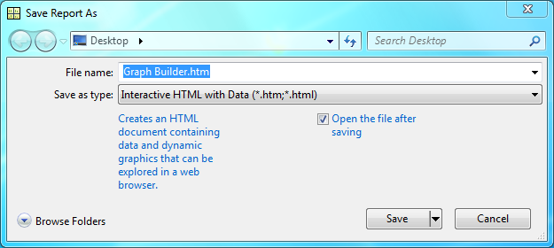

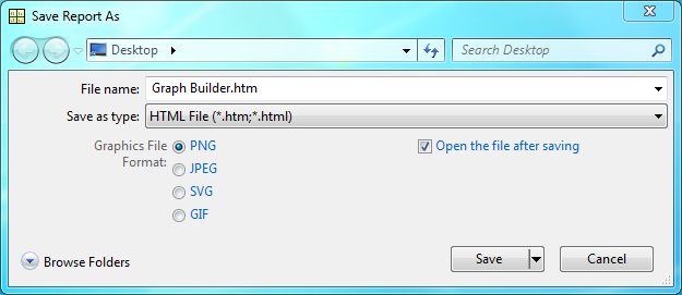

To save a JMP report in HTML5 format, choose “File: Save As:” on Windows, or “File: Export” on the Mac. Save as type “Interactive HTML with Data”. This creates an Interactive HTML file in the specified directory.
Figure 2. “File: Save As” Dialog for Interactive HTML

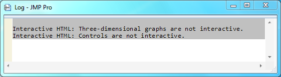

Interactive HTML supports the most frequently used features of JMP. If your report contains a feature that is not supported, you’ll see a warning in the dialog, and a more detailed message in the JMP Log, as shown in the figures below.
Figure 3. Warning of Unsupported Feature
Figure 4. Log Message

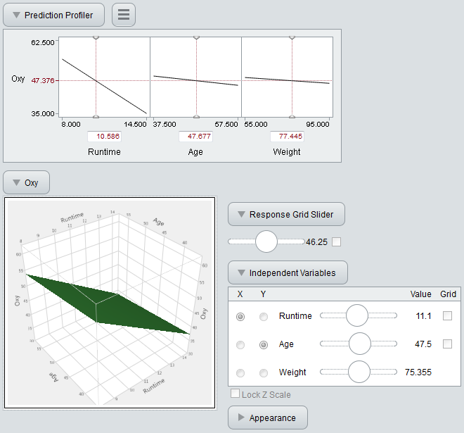

If a feature is unsupported, part of your report will be exported as a static image. In the figure below, the two-dimensional profiler is interactive. As the log message indicated, the three-dimensional profiler and the controls beside it are static.
Figure 5. Interactive 2D Profiler, with Static 3D Profiler

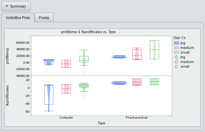

In JMP 13, we've added support for reports created with Graph Builder. This includes the most frequently used features of Points, Smoothers, Ellipses, Lines, Bars, Areas, Box Plots, Histograms, Heatmaps, Mosaic Plots, Caption Boxes, and Map Shapes. These Graph Builder elements are highlighted in the figure below.
Figure 8. Graph Builder Elements

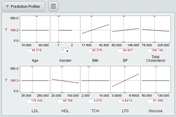

Three new embedded profilers support Neural, Generalized Regression, and Generalized Linear Model reports. Also, profilers have improved support for adaptive Y axes, formatted X values, wrapped layouts, and mixture designs.
Figure 12. Generalized Regression Profiler with Wrapped Layout

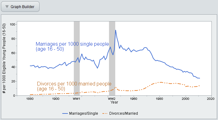

Reference ranges, value labels, and value ordering enable more descriptive graphs.  The graph below uses these features to illustrate marriage and divorce rates over time.
Figure 13. Marriage and Divorce Rates

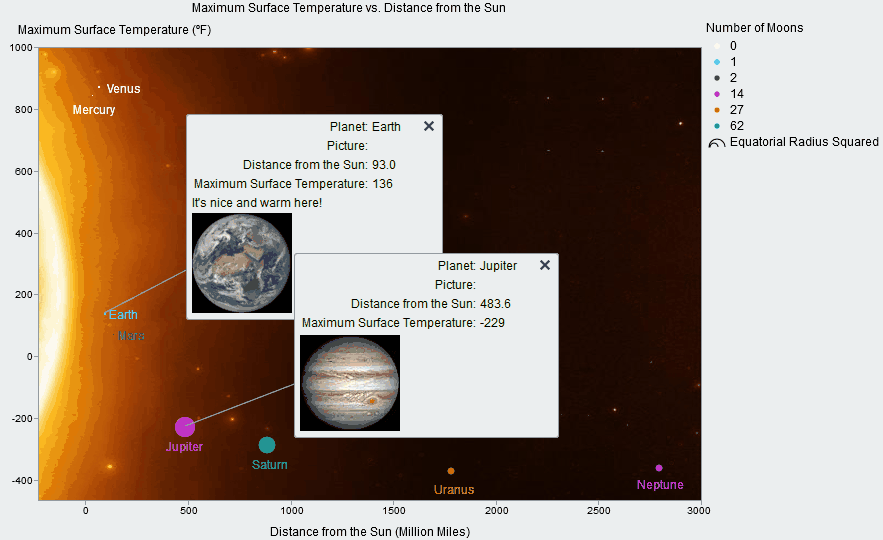

Images in pinned and popup tips enable more enjoyable and efficient presentation and exploration.  The figure below shows information about the planets plotted by their distance from the sun.
Figure 14. Images in Pinned and Popup Tips

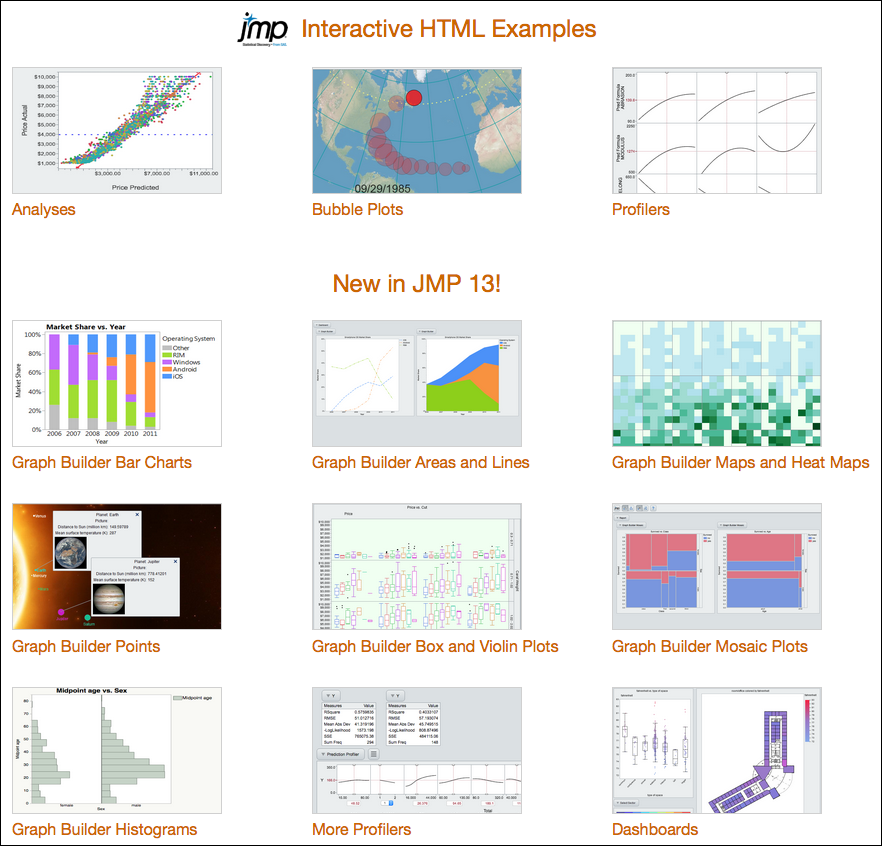

This paper has shown many static images, but that is no substitute for interacting with the web pages themselves. You can explore all features of JMP Interactive HTML at http://www.jmp.com/jmphtml5/.
We look forward to your comments and suggestions as we continue to develop our part of JMP.
Figure 15.  JMP 13 Interactive HTML Examples, Organized with “View: Create Web Report”.
