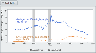

Reference ranges, value labels, and value ordering enable more descriptive graphs. The graph below uses these features to illustrate marriage and divorce rates over time.
Figure 13. Marriage and Divorce Rates
