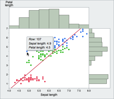

The graph below shows a bivariate fit using Iris.jmp, a JMP sample data table containing Fisher's measurements of three different iris species. One data point has been identified with its X and Y coordinates and row number. The table below shows a p-value with its associated description.
Figure 12: Identifying Data Values
