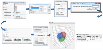

The second method is the k-means clustering method. It consists in building of k groups or clusters, one part being assigned to the nearest cluster.

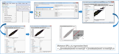

The third method used is deviation estimation from a linear regression: in that case, tests are studied two by two. It is a bivariate method used when the tests are highly correlated.

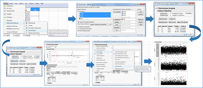

In the discriminant analysis, we search a test result combination that allows to predict if a part is failing or not: it is about again a Mahalanobis distance. For that test combination, the distance is maximal between the two groups.

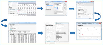

In the Partial Least Square, we search to select tests where the variance that is to say the data brought by them, is maximal but also where correlation between parts and response ‘failed or not’ is maximal.

Figure 3: K-means clustering method
Figure 4: Deviation estimation from a linear regression
Figure 5: Discriminant analysis
Figure 6: Partial Least Square (PLS)

For our same case study, methods with learning failed; one reason seems to be that the group of failing parts is constituted only by one return.

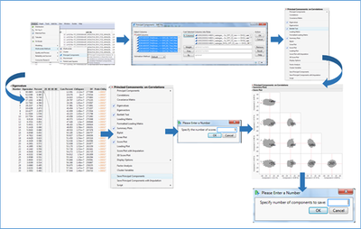

We performed a typical PCA on the automotive valve driver of our case study: unfortunately, after a space size reduction, yield loss was higher to detect the same return. That seems coherent with the fact that a PCA is going to search for majority data.
Figure 7: Principal Component Analysis

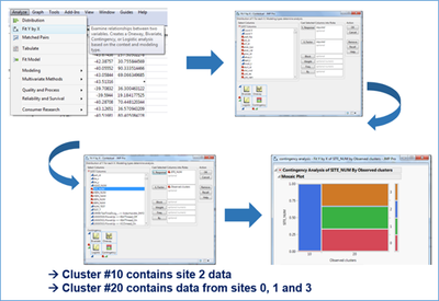

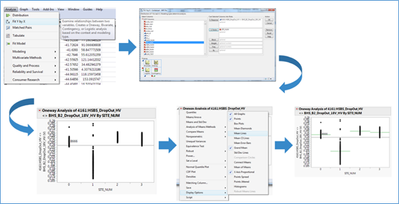

For the case study, we wanted to vizualize noise due the 4 sites on which the parts were tested, with some statistical analysis (‘noise analysis.jmp’).
The first one is a new k-means clustering method led on the test results: we succeeded to clearly see two clusters. One of them gathered data from only one test site. And the other one, the 3 other sites. This result was confirmed by a contingency analysis. It is always possible to lead a more typical ANOVA analysis. In that example on one test, we see clearly that a mean for one site is different from the three other ones.
    Figure 8: K-means clustering method to visualize tester variability
   Figure 9: Contingency analysis
     Figure 10: ANOVA
Finally, the best opportunity to reduce noise is of course to lead a gage study and to take corrective actions against the noise sources revealed by the gage study. For this case study, where the noise is found after part tests, a possibility could be to shift and to align all the means for each site. That decreases yield loss.

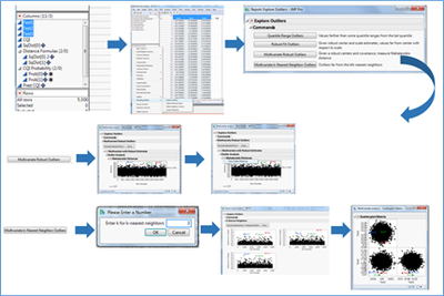

5.    ‘Explore Outliers’ jmp platform
Another quick possibility to screen outliers and remove them from a data file is the new ‘Explore Outliers’ platform. The last two options on that platform fit with multivariate analysis of Mahalanobis distance estimation and k-means clustering method.
    Figure 11. ‘Explore Outliers’ utility
     Figure 10: ANOVA
