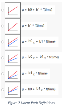

There are total of thirteen path definitions. The first six are all linear in parameters; see Figure 7. And the fitted functions are straight lines in transformed space, if the distribution belongs to the location-scale family. If one chooses a log-location-scale distribution, the solid lines in the graph will be curved. The points on solid lines drawn in the graph are medians associated with each distributions, time, and other factors. The points on the boundaries of shades are the lower and upper percentiles.
