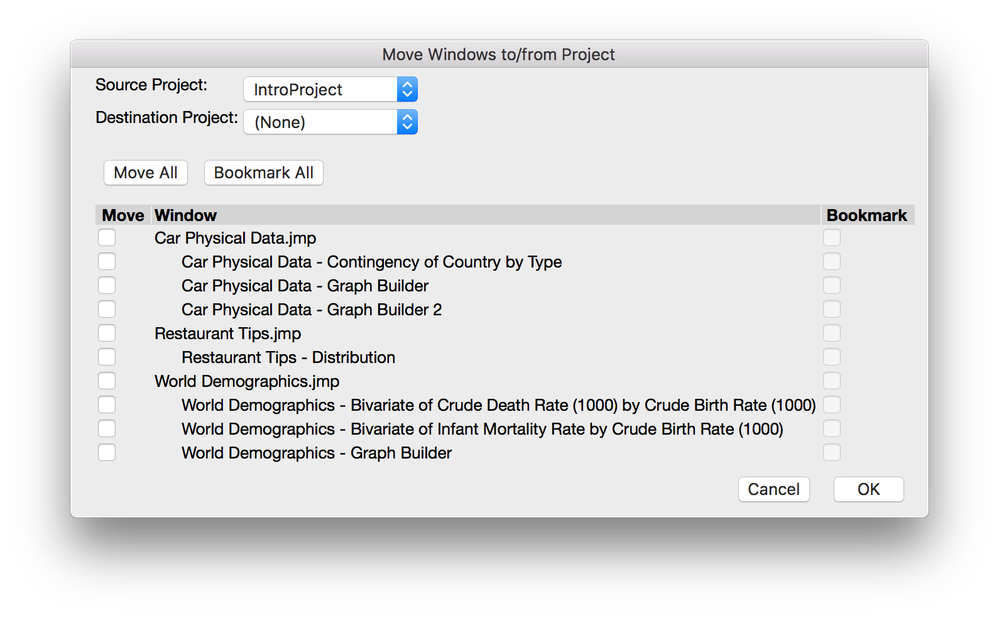

Many users will want to move from a project to multiple window mode, from multiple window mode to a project (using the project just for encapsulating a session), or from project to project (when a single analysis project gets to complex, for example). For that, use the Window > Move To/From Project as shown in Figure 3.
Simply pick the source project (or none if you want to move items from individual, separate windows) and destination project (which can be none, a new project or an existing open project). There are quick buttons for moving and bookmarking all files, or you can pick a subset of data tables and associated reports from source to destination.
Clicking a data table automatically brings over any report windows opened in the current project. If you don’t wish to keep them, simply close the tabs or windows after the move is complete. Data tables can also be bookmarked directly from this window. Also note that data tables must be saved on disk to be able to be bookmarked from this tool. Unsaved files can still be moved, however, to a new project or multiple windows.
Clicking on an individual line in the table brings up a useful thumbnail, which can help in deciding which files and associated graphs and reports are needed in the move.
ProjectsFig3.pngFigure 3. Move To/From Project window.
