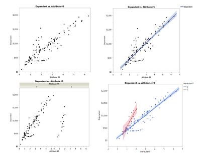

The most basic modification of a graphic is the selection of relevant information to be displayed. Figure 1 illustrates the capability to include more or less information by selecting certain layers.
Figure 1: Example of selection layers
The first picture removes focus from dollars and statistics and allows the overall trend and individual points to stand out. The second and third bring in axis, summary statistic, and graph title information, switching focus to numeric values and model quality.

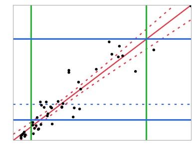

Figure 3 gives an example of how axis settings can be customized with reference lines to draw attention to a specific area within the graphic.

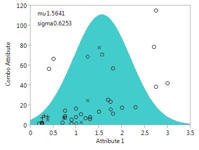

Applying JSL can provide additional information without much effort. Figure 5 illustrates using two built in functions which can add a marker and label anywhere in the graphic.
Figure 5: Simple marker and label output
This marker can also be colored and labeled with text.  These features are useful anytime a customer or supplier provides information that adds to the message of the graphic but will not be included in any analysis. Adding features like markers will only overlay information onto the graphic not impacting any underlying or future analysis. Additionally, adding shapes instead of just simple markers and lines can add more detail.

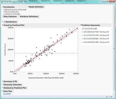

Figure 8 shows an example layout for a peer review JMP® Journal. Key charts are located in the JMP® Journal along with written notes relating to the analysis and a link to the original data file. Each of these outline sections can be expanded or collapsed to show relevant information. Additionally, the location of each of the outline sections can be changed to put related items close together or direct flow from one item to the next. This sort of presentation also lends itself well to fellow JMP® users that would like to use the analysis results or the underlying data.
