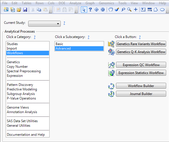

GWAS analyses have long been supported in JMP-Genomics. Easy to follow work flows are available for Q-K Analysis, or GWAS accounting for population structure and kinship.
Figure 1: Q-K Mixed Model Workflow

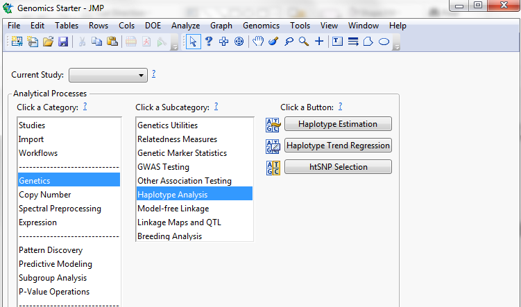

Figure 7: Haplotype Estimation path
Figure 8: Haplotype Analysis setup

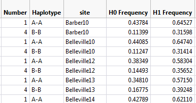

In the Haplotype Trend Regression Results, open the haplotype frequency estimates (_hfr) files. Look for clearly differentiated haplotypes which make up 90% of the material (the remainder could be errors in genotyping or very rare haplotypes). Take note of the haplotype number and allele calls for future reference.
Figure 9: Haplotype analysis results window
Figure 10: File needed (_hfr) that will be added on for meta-haplotype analysis
Then launch haplotype trend regression, which results in SAS output. Look for the haplotype number within the given site or year and append estimate and standard error in the (_hfr) file. Save file with new name for meta-analysis of the significant haplotypes.

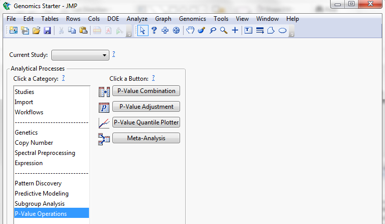

Applying a meta-analysis over the significant haplotypes in all years and in all phenotypes we were able to see the effects of these QTL over all traits.
Figure 12: Path to haplotype meta-analysis
