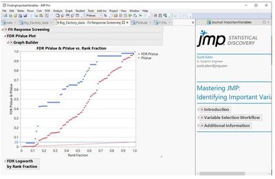

Q: When would you use a Journal vs Project?
A: Consider using them together. Projects are a Presentation environment. Journals are more like a slide deck. Journals are good for organizing content but not as good as Projects for storing content.
