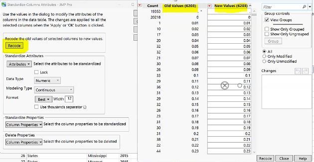

Q: Is there a good way to recode values across multiple columns?
A: Yes, you can recode across columns where the values are the same data types.
