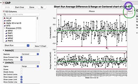

Q: Can I calculate using different spec limits for different variables?
A: If you have different spec limits, that implies there are 2 different levels of variance in your process.  Generally speaking, handling one spec limit per column of data is the preferred, historical approach. If they have the same underlying process but  are different products, you might use a Short Run Control Chart.  You can turn on the Short Control Chart option then select Part to assign to different products that have different control limits, that may exist withing the same processing capability.  But,  specifying this analysis pretty tricky and creates issues for creating Cpk and determining where control limits come from. See below.

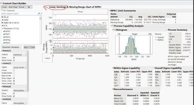

Q: Can I plot Levey Jennings control chart using control chart builder?
A: Yes.  It’s just a change to the variability method in the IMR chart in the chart properties.

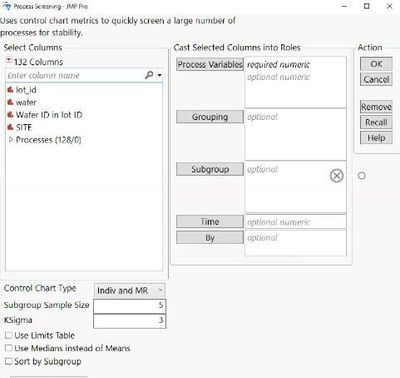

Q: In Process Screening, what is the difference between grouping and "group by”?
A:  Grouping is used when you want each process variable  analyzed at each combination of levels of the grouping variables. The results are presented in a single report.  So, Grouping gives you the ability to break up a channel into multiple sub-channels. For example, when you have one data set coming in with multiple tools attached to that one stream of data, you could clip it out using the grouping.  (Group) By is for a column whose levels define separate analyses.  For each level of the specified column, the corresponding rows are analyzed using the other variables that you have specified. The results are presented in separate tables and reports. If more than one By variable is assigned, a separate analysis is produced for each possible combination of the levels of the By variables.
