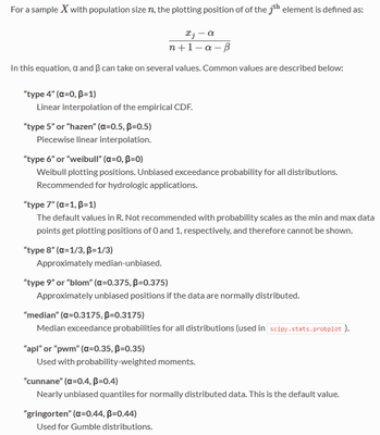

Please add an option for Cumulative Probabiltiy -
[edit: more general
maybe even a setting which allows us to specify the plotting positions:

Other tools give the user the possibility to adjust the way the plotting positions are calculated.

could you please re-open the wish for:
1) Cumulative Probability: Denominator = N+1
2) add a setting which allows the user to choose between
- max (like CDF)
- midpoint (like Prob Scores in Distribution)
- individual points (like standard Col Rank and Life Distribution)
- min (if somebody needs this as well)
