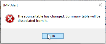

e.g. "cut the link", like it's done for linked summary tables:
sort → no [why does SORT not "cut the link"?!?]
add rows → yes²
concatenate → yes²
² JMP automatically cuts the link:
