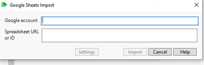

  2. Select File > Internet Open > Google Sheets
  3. Enter your Google Account email address for Google account
  4. Enter the Google Sheet web address for Spreadsheet URL or ID
  5. Click Settings

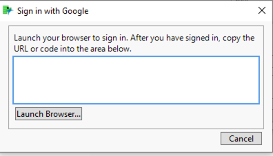

6. In the Sign in with Google window, click Launch Browser
7. Select the Google account you want to use to sign in
8. Click Continue

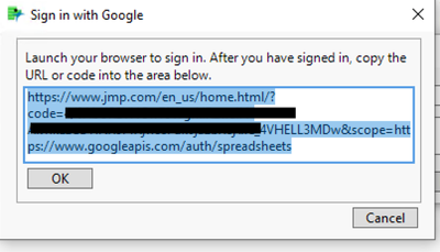

9. In the browser window that opens, copy the web address (URL) from the address bar (see yellow outline)
10. Paste the web address in the Sign in with Google window (outlined in blue)
