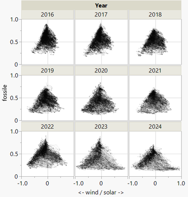

It almost looks like art - but it is data !
from: Fraunhofer ISE: solar / wind / fossil energy generation in Germany per bin of 15 mit to several hours *).
On the Y axis you see the fossil power generation, and on the X axis the split between wind (left) and solar(right).

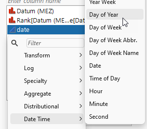

Via right click - new formula column / Date Time / Day of year

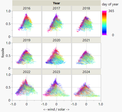

one can add some color - with a cyclic scheme like Hue.
Hue is not available by default, but it's easy to generate:
Color Theme(
	{"Hue", {"Continuous", "Categorical", "Chromatic"}, {{248, 10, 254}, {0,
	0, 255}, {0, 127, 255}, {0, 255, 255}, {127, 255, 127}, {255, 255, 0},
	{255, 127, 0}, {255, 0, 0}, {254, 5, 235}, Missing( {120, 120, 124} )}}
And with some transparency added, one can get a feeling for the density of the data points:
The transparency is also applied to the legend, this makes it hard to read.
To fix the issue, just add another column as "color" and use it for the legend ... and hide the original one.
in total:
