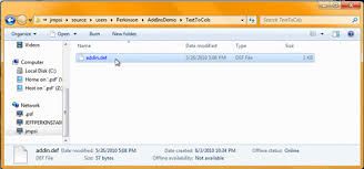

In your add-in folder, create a text file called "addin.def".
The contents of this file should be as follows, substituting your unique ID and display name as appropriate:
id="com.jmp.jperk.texttocols"
name="Text to Columns"
Now, you need to register your add-in with JMP. Do this by opening the addin.def file with JMP. When you do this, JMP will prompt you to ask if you want to install your add-in.
This seems odd at first, but you'll need this so JMP knows about your add-in as you develop it. Go ahead and click "Install" to complete the registration.

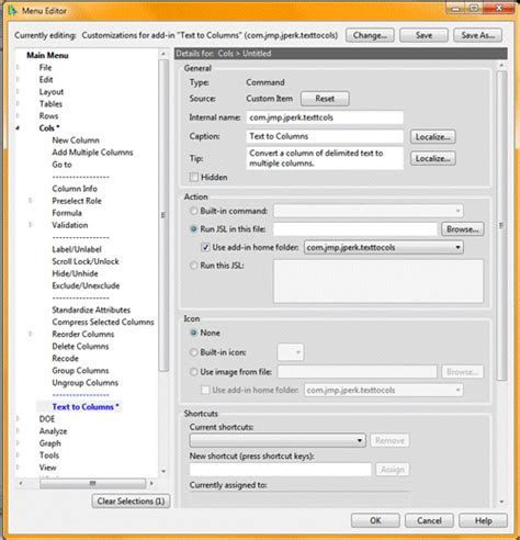

After your JSL is complete, you'll need to build a custom menu, so users of your add-in can access it.
Go to View->Customize->Menus and Toolbars to launch the menu editor.
Click the "Change..." button at the top of the editor to change to editing customizations for your add-in.
Now, you can create a custom menu item to launch your JSL. I'm putting mine in the Columns menu after a separator.
Give your menu command a unique, Internal Name. This is the name that JMP will use to find this menu item if it's referred to by other custom menus. Next, put the text of the menu item itself in the Caption field. This is what will be shown in the menu. You can also insert a tooltip in the Tip field. Use the Localize buttons to put localized versions of the Caption and Tip, if you desire.
In the "Action" section, choose "Run JSL in this file" and then click the the checkbox next to "Use add-in home folder" and make sure that your add-in ID is chosen.
Note the "Icon" section where you could use an image file from your add-in home folder as the icon for your menu item.
When you click "OK", JMP will save the customization file you just created in your add-in directory as "addin.jmpcust".
