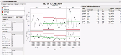

  1. From an open JMP® data table, select Analyze > Quality and Process > Control Chart Builder.

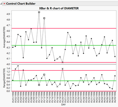

  2. Drag a continuous variable from Select Columns (continuous variables have blue triangles), and drop it in the Y zone.  Here we used ‘Diameter’.
  3. Drag and drop a subgroup variable in the Subgroup zone (at the bottom).  Here we used ‘Day’. By default, JMP produces a control limit summaries table and two charts: XBar (subgroup average) and  Range (subgroup range). Right-click on the bottom graph and select Points > Statistic to change from a Range chart to an S Chart, and use Limits > Sigma to change the method for estimating the standard deviation.
  4. If available, drag and drop a variable in the Phase zone (top), and click the Done button when finished.  Here we used ‘Operator’.
