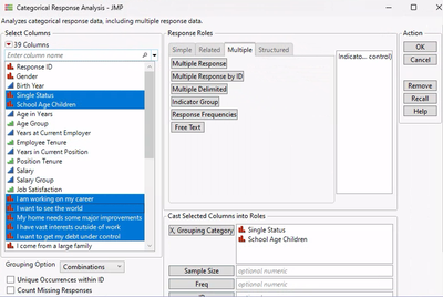

  1. From an open JMP® data table, select Analyze > Consumer > Research > Categorical.
    Note: There are many options on the types of of analyses and the format of the data that can performed with this platform. This guide illustrates just one of those – comparing binary outcomes (“Agree” or “Disagree”) across a multiple response survey from different types of responders.
  2. Select the Multiple tab. Select the set of variables representing the “Agree/Disagree” questions. Choose Indicator Group as the answers in this survey are binary.

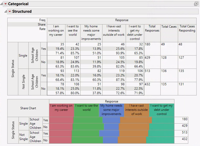

  3. Select one or more variables defining the types of responders and place in the X, Grouping Category role. Click OK. A Cross-tabulation table and visualization is the default output.

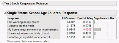

  1. Select Test Multiple Responses > Count Test, Poisson under the top red triangle to test for equality across the type of responders.
    Note: This test is chosen since each responder can answer “Agreed” to more than one question.

Intepretation:
The Total Responses is the total number of “Agreed” that occurred across all questions for each type of responders (‘Single Status’ and ‘School Age Children’). Total Cases is the number of responders of each type. Total Cases Responding is the number of responders who answered “Agreed” to at least one question. Each count in the cells is the number of responders who “Agreed” to each question. The first set of percents are the percentage of responders who answered “Agreed” to each question per Total Responses. The second set of percents are the percentage of responders who answered “Agreed” per Total Cases.
