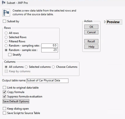

  1. From an open JMP data table, select Tables > Subset.
  2. Specify how you’d like the sample to be selected:
  • Random – sampling rate (specify the proportion).
  • Random – sample size (specify the desired sample size).
  • To select a stratified sample across another variable, check Stratify and select the variable.
  1. Under Columns, specify All columns or Selected columns.
  2. Click OK to generate the random sample.

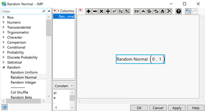

  4. Right-click on the column and select Formula. This takes you to the JMP Formula Editor.
  5. Click on the gray icon next to Random in the function list on the left, and select the distribution of interest. Here, we will select Random Normal.

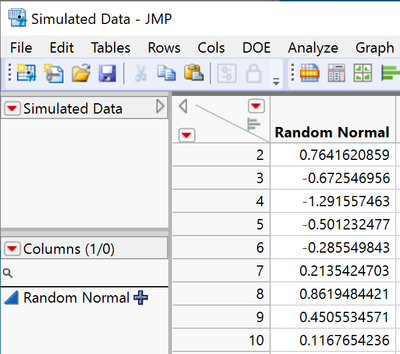

  6. Click on the caret once to add the standard deviation field. Type in the desired values for the mean and standard deviation. Click OK. JMP will populate the new column with simulated random normal data.
Simulated random standard normal data. The fat plus sign next to the variable name under the Columns panel tells us that a formula is stored in that column.Simulated random standard normal data. The fat plus sign next to the variable name under the Columns panel tells us that a formula is stored in that column.
