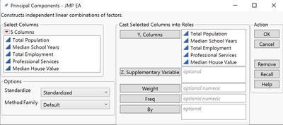

  1.  From an open JMP® data table, select Analyze > Multivariate Methods > Principal Components.
  2. Select continuous variables from Select Columns, and Click Y, Columns (continuous variables have blue triangles).
  3. Click OK.

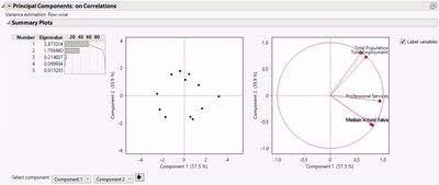

By default, JMP displays the eigenvalues and three Summary Plots.
  • Eigenvalue Pareto Plot: The percent and
    cumulative total percent of the variation accounted for by each principal component.
  • Score Plot (middle): A scatterplot of the first two principal components.  Use the options at the bottom to select any two components to display.
  • Loading Plot: Correlations between the original variables and the two selected principal components. (Note: The factor loadings are unrotated.)

• The first two principal components account for 93.4% (57.5 + 35.9 = 93.4) of the total variation in the data (see the Pareto Plot). These numbers are displayed on the graph axes of the Score Plot and Loading Plot.
• All of the original variables are positively correlated with the first principal component (see the Loading Plot). Total Population and Total Employment are positively correlated with the second principal component, while the other variables are negatively correlated with the second principal component.
