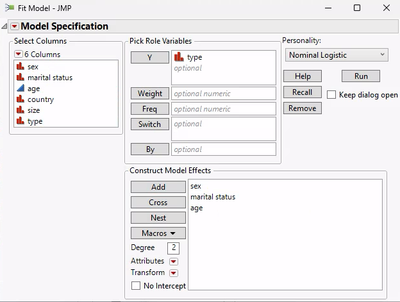

  1. From an open JMP® data table, select Analyze > Fit Model.
  2. Click on a categorical variable from Select Columns, and click Y (nominal variables have red bars, ordinal variables have green bars).
  3. Choose explanatory variables from Select Columns,and click Add.

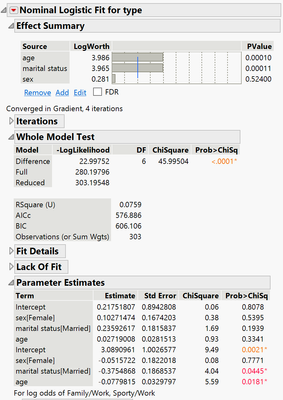

  4. Click Run Model. By default, JMP will provide the following results:
  • The Iterations history (not shown).
  • The Whole Model Test.
  • Lack of Fit (not shown).
  • Parameter Estimates for the model.
  • Effect Likelihood Ratio Tests (not shown).

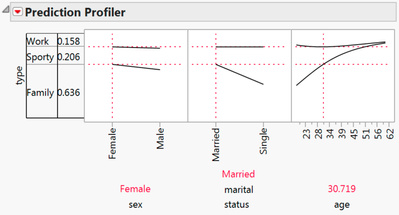

  • To view the effect of an explanatory variable on the predicted probabilities, click on the top red triangle and select Profiler. In the Prediction Profiler, click and drag the vertical red line for a variable to change the level or value. The predicted probabilities are displayed.
