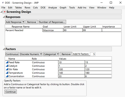

  2. Specify the Response(s):
  • Double-click on Y, under Response Name, to name the response.
  • If needed, change the response Goal and Upper and Lower Limits. Click Add Response to add additional responses.
  1. Specify the Factors
  • Add the desired number of Continuous (2-level) and/or 2- or 3-Level Categorical factors.
  • Add the factor names and levels.

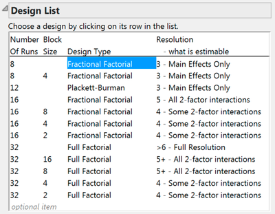

  1. Click Continue. From the Design List, select the desired design and click Continue.  Note: Choose an appropriate block size (i.e., runs within each block) if there is a blocking variable that needs to be accounted for in the experiment. Full factorial designs are also available to choose.

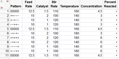

  2. Specify the Run Order (default is Randomize), the Number of Center Points and the Number of Replicates (the number of additional sets of runs for each design point). Here we created an unreplicated fully randomized 25-2 fractional factorial design with 3 center points, totaling 11 runs.
  3. Select Make Table to generate the design table (or Back to make changes). The Screening and Model scripts will be saved to the data table and the design specification window stays open to change or regenerate the design.

To create an 8 run 25-2 Resolution III fractional factorial design.To create an 8 run 25-2 Resolution III fractional factorial design.
