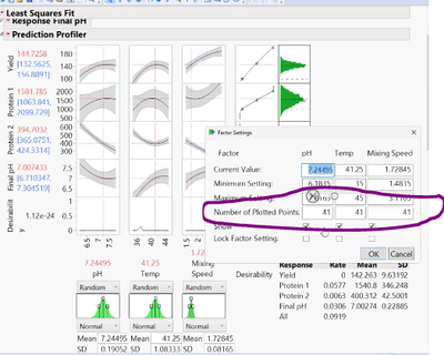

Q: When we were resetting the factor grid, did the numbers 41 indicate 41 levels for each factor?
A; Yes.

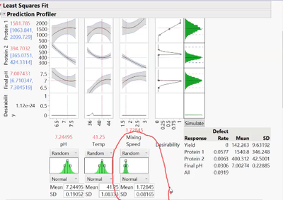

Q: How do you determine SD for the simulation?
A:  When you're doing simulation, standard deviation comes up in  different ways.  You have to determine  what standard deviation to use when interjecting  random noise around each of your factors when doing the simulation. JMP proposes standard deviations, but you, as a subject matter expert, can modify them. For example, you may know about some ability in terms of temperature control on your equipment and want to to access process knowledge and some historical data to help you determine what SD to choose.

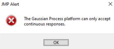

Q: Can Gaussian Process model in JMP handle categorical factors?
A: No, neither JMP nor JMP Pro or Standard will categorical Y response.   @PatrickGiuliano  clarified this after the session.  However, X assigns the columns to use as explanatory variables for Gaussian Process.  Categorical variables are allowed in JMP Pro when the Fast GASP option is specified.
