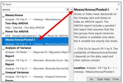

Search JMP to get info and path for the analysisSearch JMP to get info and path for the analysisSearch JMP to get info and path for the analysis
