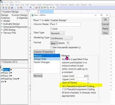

Q: Does JMP do pseudo-coding under the hood, or do you need to specify that somewhere?
A: JMP does it.  From Column Info, you can specify the type of psuedo-coding.  If you are analyzing an experiment that has not been done in JMP, you will need to make sure the column properties are set.
