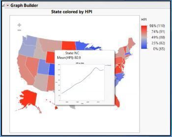

When you hover over a visual element in a graph, usually you see a basic description of the data point in a Hover Label. You can also easily add one or more levels of interactive graphs with data point infomation to a Hover Label using Graphlets. These drill-down graphs are predefined and editable. Note: Hover Labels are saved to interactive html. Drilling into Graphlets requires JMP or JMP Pro, so Graphlets are available when you save to formats that include JMP data, like JMP Projects, Journals and Applications. Custom drill-down graphs are not available when you save and share interactive html outside of JMP.

Q: Can images be added as hover labels?
A: Yes, you can add static images or interactive graphs.

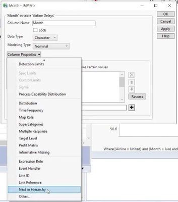

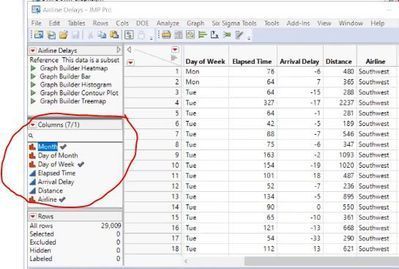

Q: How did JMP know Month and Day were hierarchical and to display them when choosing a line graph instead of some other variable on the x axis?
A: JMP is looking by default for the next column in the data table. There is a column property to define the hierarchy called "Next in Hierarchy".

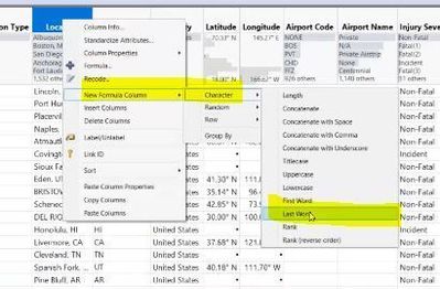

Q: The standard data set for airline incidents doesn't have "Last[Location]". How did you get that column?
A: From my Location column, R-click, then choose New Formula Column>Character>Last Word. Then the last work gives you a column with State Abbreviations.
Using Formua to Create a Last Word Column

Using Column Order to determine what goes on drill-down graph
Next in Hierarchy Column Property

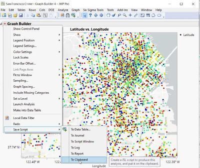

Save Script to Clipboard to start nesting graphlet Hover Label code
Paste Graphlet Code to Build Hover Label Code for Graph
