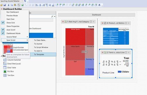

Q: Can I save the Dashboard as a Template?
A: Yes, from Dashboard Builder, Save Script>To Template.  You can also save it to and Add-In from there.
