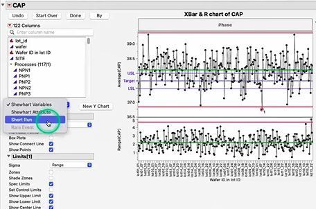

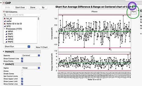

Q: Can I calculate using different spec limits for different variables?
A: If you have different spec limits, that implies there are 2 different levels of variance in your process.  Generally speaking, handling one spec limit per column of data is the preferred, historical approach. If they have the same underlying process but  are different products, you might use a Short Run Control Chart.  You can turn on the Short Control Chart option then select Part to assign to different products that have different control limits, that may exist withing the same processing capability.  But,  specifying this analysis pretty tricky and creates issues for creating Cpk and determining where control limits come from. See below.

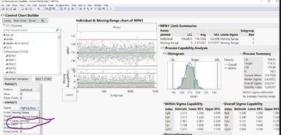

Q: Can I plot Levey Jennings control chart using control chart builder?
A: Yes.  It’s just a change to the variability method in the IMR chart in the chart properties.

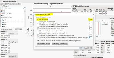

Q: Can we define our own tests?
A: Yes, there is a custom test option.  In Control chart Builder, Customize Tests is available in the right-click men for some chart types. It enables you to design custom tests and select or deselect multiple tests at once. After the option is selected, the Customize Tests window appears for designing the tests. Select a test description and enter the desired number (n) and label. You can save the settings to preferences and restore the default settings. Available only for Variables and Attribute chart types. See the documentation for more details.
In Process Screening, Choose Tests enables you to choose the tests that you want to include in the calculation of Alarm Rate and Any Alarm.  To select multiple tests, press Alt and click the Process Screening red triangle to open a menu of all platform options. See the documentation for more details.
Customize Tests - Control Chart BuilderrCustomize Tests - Control Chart BuilderrCustomize Tests - Control Chart Builderr

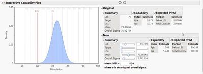

Q: Can JMP help me use historical data to create specification limits?
A: Yes, you can fit distributions to historical data and also use the Interactive Capability Plot to explore the impact of changing specification limits.
