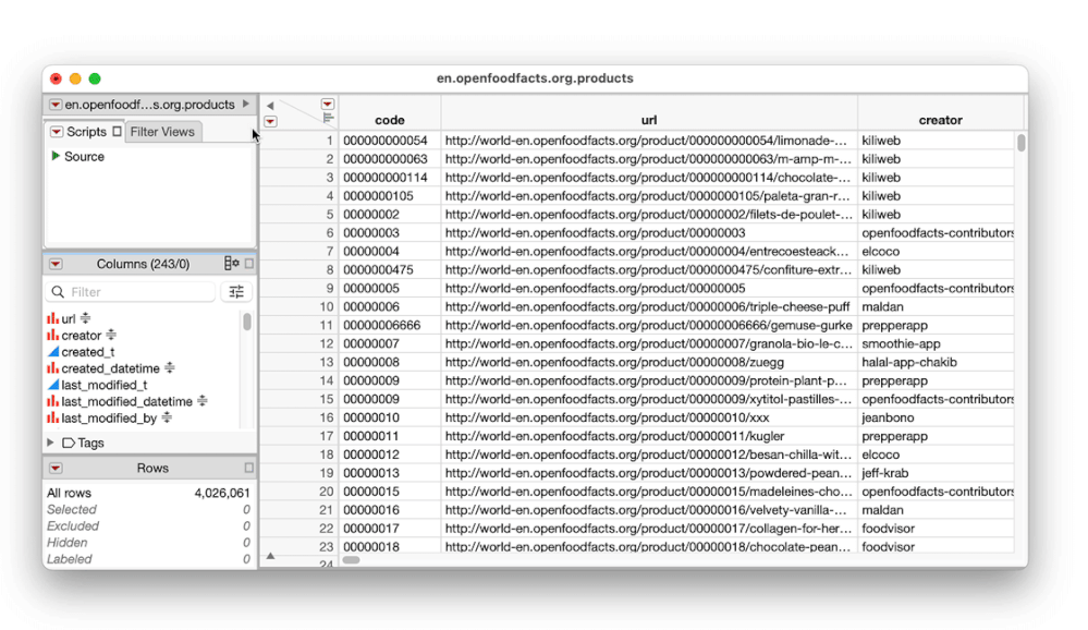

This file, however, is not for the faint of heart! The uncompressed CSV is 11.6gb, coming in at just over 4 million rows with 243 columns (as of September 2025; the database is continuously updated). Tables like these are unusually hard to navigate, but several new tools in JMP make it easy to keep things organized. Let’s start with organizing those 243 columns.
Organizing columns
Maximize columns list

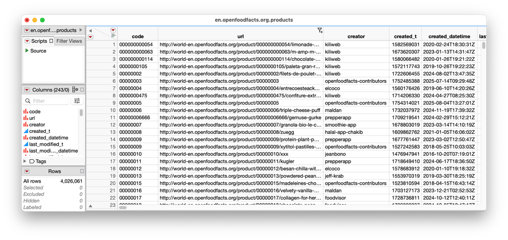

The first thing I’ll do is maximize the columns list in the data table, a new feature in JMP. It’s a simple feature but an incredibly useful one! In fact, any of the tools on the left can be maximized so you can see more of them. In addition to the columns list, being able to maximize an area can be especially useful if you have a large number of table scripts.

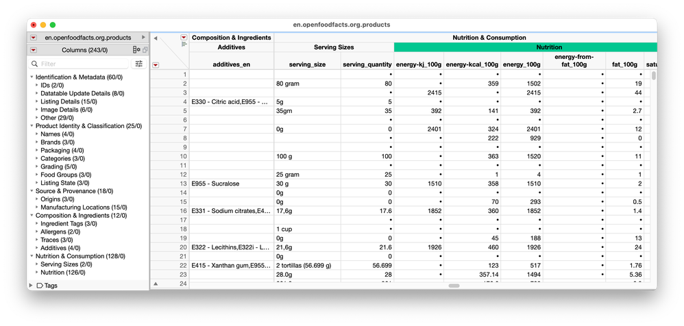

For this table, I’ll first start with an initial grouping of similar columns by selecting the columns I want to group, then I will right click in the columns list, then Group Columns.
In a table this big, the grouping process will take a little time and care, but after this first round of grouping, our table is already looking more organized.

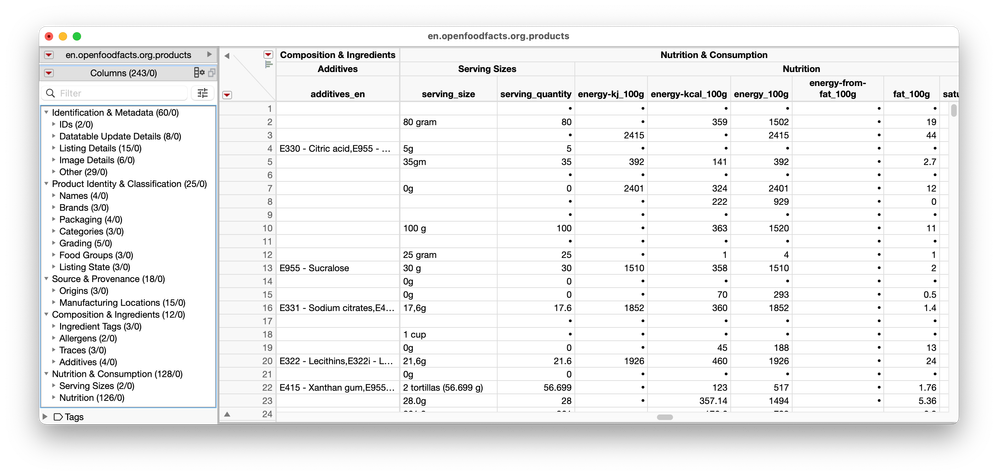

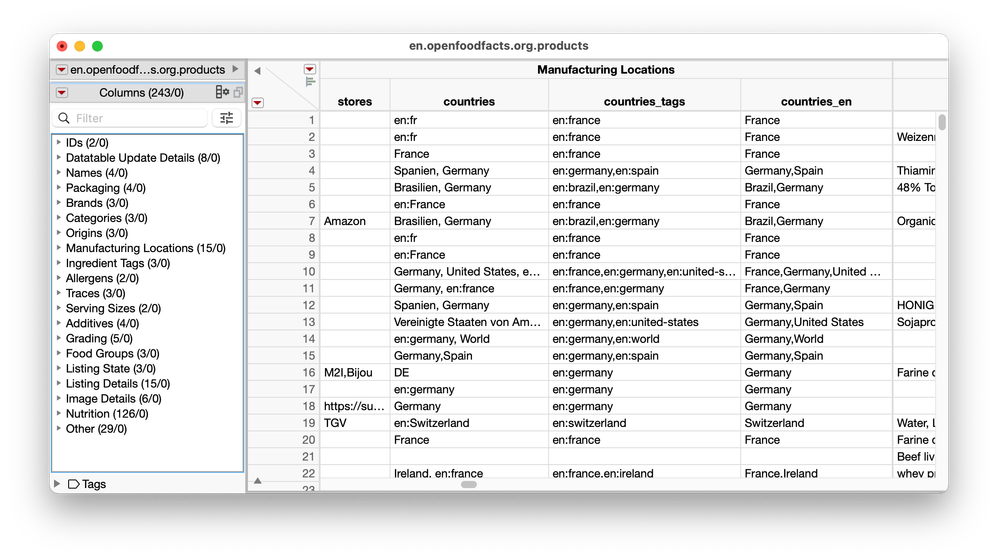

Because we can have multiple levels of grouping, we can go one step further by taking these column groups and putting them into groups themselves.

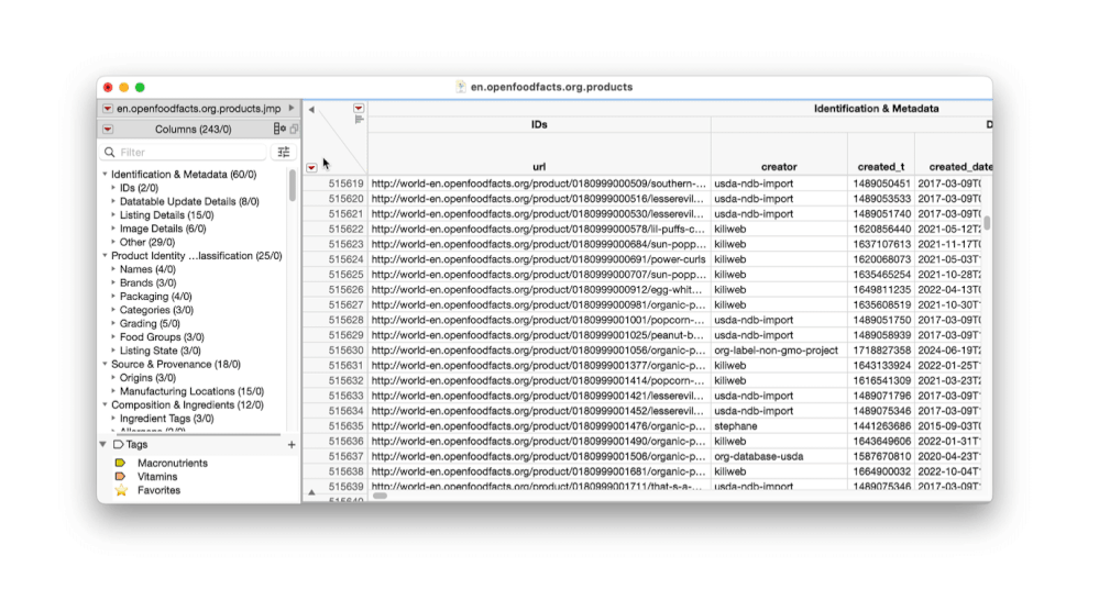

To do this, I'll select similar column groups and again right-click to group these groups into larger metagroupings of Identification & Metadata (these define what the record is and how it’s tracked), Product Identity & Classification (these describe the product’s “who and what”), Source & Provenance (where the product comes from and how it’s made), Composition & Ingredients (what goes into a product), and Nutrition & Consumption (what it provides to the consumer and in what quantity).
After further grouping our table, our columns list is far more neatly organized and finding columns of specific types becomes far easier. You may also notice that the groups show up in the table header, helping us keep track of which section each of our columns are in.

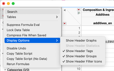

Note: For deeply nested tables, you might want to turn off the display of the groups in the table header. You can edit what shows in the table header clicking the red triangle at the top left of the table, then Display Options>Show Header Groups.

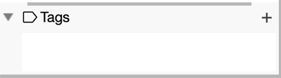

We can also make tags before applying them by clicking the + button in the Tags area. I find this useful when there are many tags I will use in the table; I can also make them ahead of time for easy application later. I also do this when importing tags that I have made earlier and stored in my preferences (more on that later).

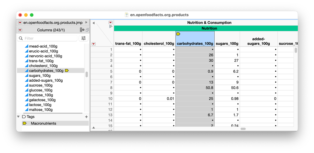

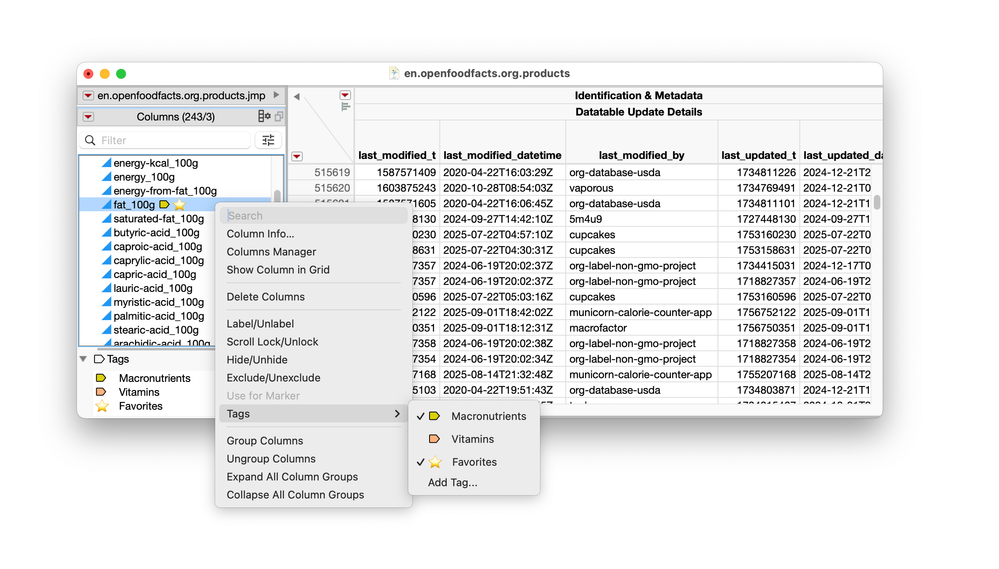

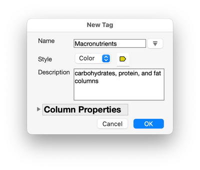

I’ll begin with Macronutrients tag. I find and select the carbohydrates, protein, and fat columns in the columns list, then right-click on of the columns>Tags>Add Tag…
The only item that must be completed in this dialog is the tag name, but I have decided to also set a tag color and description.
Because I set a tag color, I can see the tag icon in the data grid and columns list. I find this helpful to identify these columns when I’m scrolling in the table:

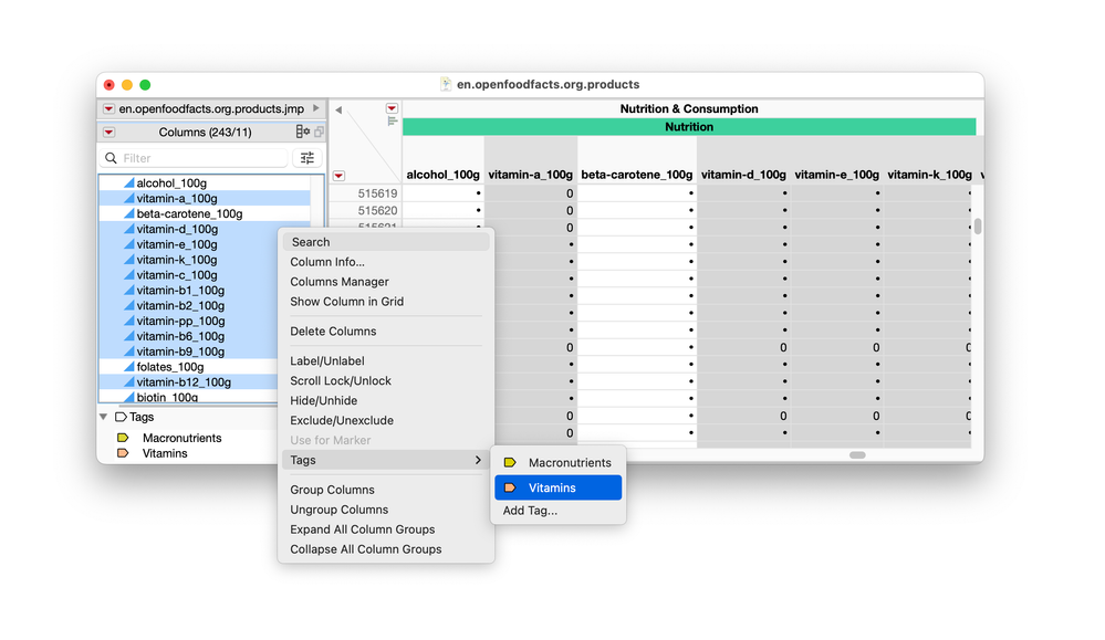

I’ll make the Vitamins tag next, this time using the + button in the Tags area.
It will create the tag, which will be listed in the Tags area of the table, but no columns will be associated with this tag until I’ve added them. I’ll select the 11 Vitamin columns, right-click on one in the columns list, then select Tags>Vitamins.

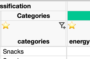

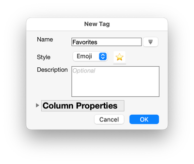

Finally, I’ll make my Favorites tag. I will again use the + in the Column Tags area, and this time, I’ll set a star emoji for this tag. This emoji will show up in the table grid and columns list wherever this tag has been set.
I’ll want to set this tag on a few different columns. First, I want it set on all my Macronutrient columns, so I will click that tag in the tags area, which will select all those columns in the table (a really useful trick!). With those columns selected, I’ll right-click one of them in the columns list, then Tags>Favorites.
Notice that columns can have many tags applied to them, which reflects the fact that conceptual grouping are often overlapping.
There are a few more columns I want tagged as a favorite, including the product name, total calories (which is named energy-kcal_100g in this table), and which category the product is in. To set those tags, I simply find those columns, right-click in the columns list, then Tags>Favorites.

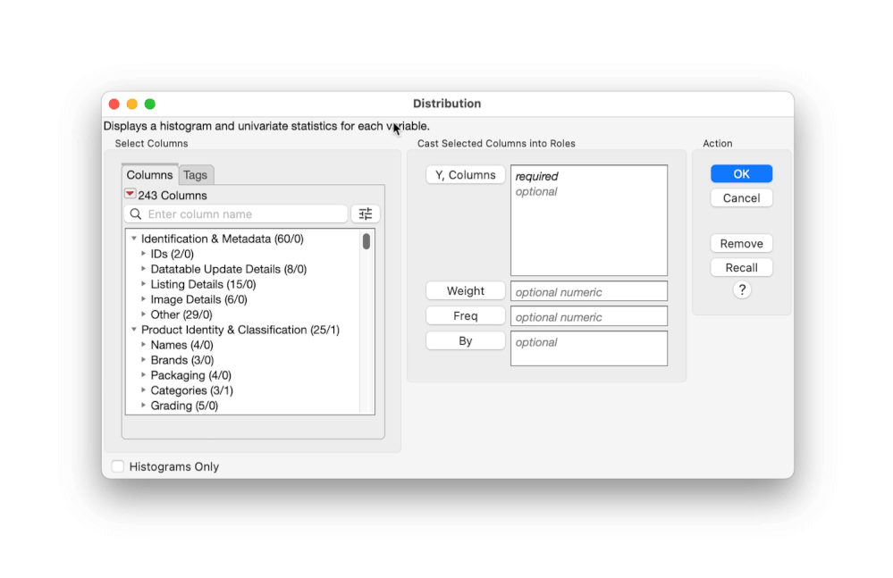

Casting columns by tag: When launching a platform, it’s possible to click into the listing of tags and cast a tag to a role instead of spending time looking for the columns of interest. The columns in that tag will populate the given role.

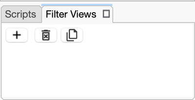

There are two ways to create a new filter view:

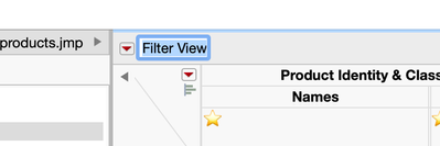

  • Click the + in the Filter Views tab of the data table (in the top left).
  • Click the filter plus icon when hovering over the header of a column, which will start a new filter view if you aren’t already in one. Or, if you are already in a filter view, pressing this icon will add this column to the list of columns being used to filter the table.

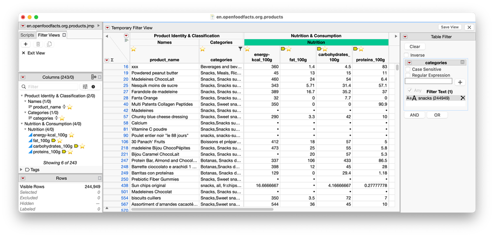

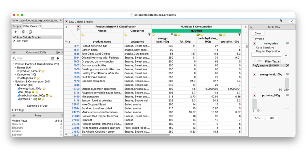

To start, I’ll click the filter plus icon on my categories column so that I can filter my table down to only certain kinds of foods.
If you’ve ever used a data filter in JMP before, you’ll recognize it on the right-hand side of the table in this new temporary filter view (the view is temporary because we have not yet saved it).
I have the categories column set as unstructured text so that I have a free text entry field to use as a search box. I’ve typed in “snacks” and set the filter to only show me those products that are in a snacks category. In this case, there are about 244k rows matching snacks somewhere in the category description.

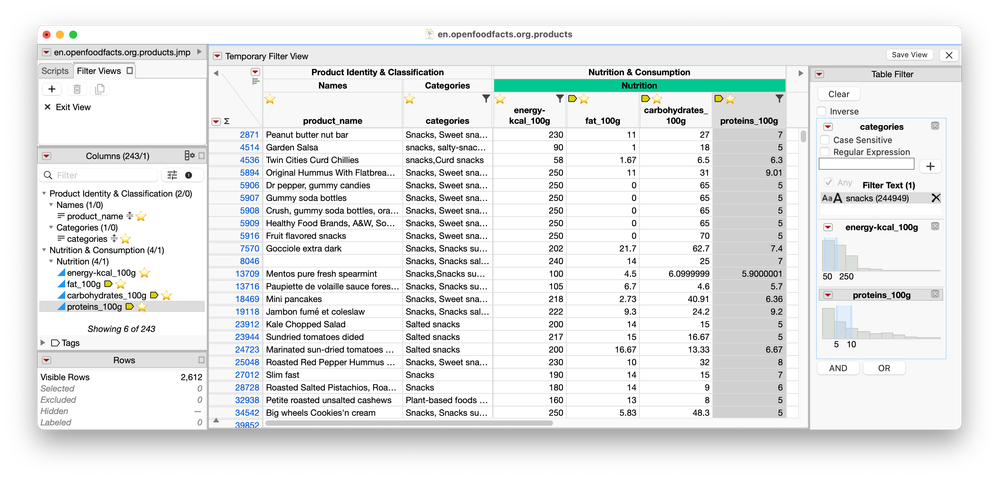

If I want to add another filter to this view, I can click the AND button in the filter, or simply hover over another column I want to add. I’ll add the Calories (energy-kcal_100g) column to my filter and set the range as 50-250. I’ll also add Protein (proteins_100g) to the filter and set that range from 5-10.
We’re left with 2,612 rows, down from the 4+ million we started with. It’s still a large number of rows, but far more navigable than the original table and might represent an important subset of the table we want to explore further.

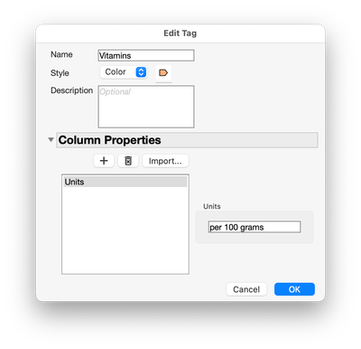

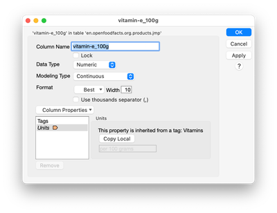

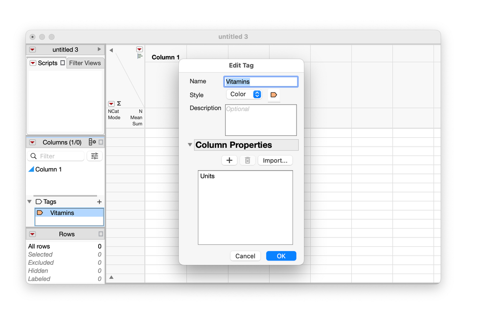

In addition to helping you organize and navigate your table, tags can contain column properties, such as Value Order, Value Labels, or Units. You can use tags to store the metadata you routinely set for columns so that when you encounter those columns, you can set a single tag rather than set many different column properties.
To set a property for a tag, right-click on the tag in the Tags list and select Edit. Then, expand the Column Properties section of the tag dialog to add the properties you want to have set for any column using this tag.
In our example here, I’ll set a column property for the Vitamins tag. Because all of these Vitamin columns are in 100s of grams, I’ll set the Units property for this tag, with the name “per 100 grams.”
Now, all of my vitamin columns have inherited this column property from the tag. To see this, I’ll select one of the Vitamin columns, right-click>Column Info.
We can see in the column properties area of column info that there is now a Units property on the column with the colored tag icon next to it, indicating that this property has been inherited from the Vitamins tag.
Advanced note: if we need to, we can override this tag-inherited column property by clicking “Copy Local.” We could then define a version of the column property that is only on this one column without disrupting the column property defined by the tag. While it is sometimes useful and necessary, we recommend that you avoid using column properties on tags you don’t want to flow through to all the columns you have tagged to keep everything conceptually clear in your data table.

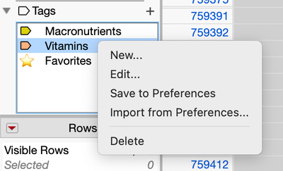

When making a tag the first time, it’s saved only on the table you used it on. However, tags are often useful across different tables, especially when working with the same kinds of data repeatedly. To save time, tags can be saved to your preferences so that you may use them later on different tables.
To save a tag to your preferences, right-click the tag and select Save to Preferences. I’ll save our Vitamins tag to my preferences now.

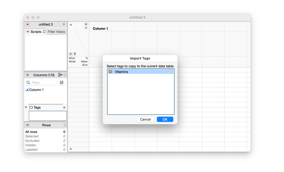

If you want to use this tag on a new table, use the Import from Preferences… option when right-clicking in the Tags area. Here is what that looks like in a blank table:
After importing this tag to the new table, I can right-click>Edit the Tag to see that all the settings and column properties I set have been retained:
