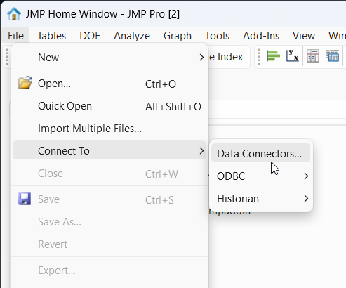

Menu access
Menu access for data connectors has changed in JMP 19; they can now be accessed, as well as Historians and Legacy ODBC, in the Connect To menu. Data connectors are found at File>Connect To>Data Connectors.

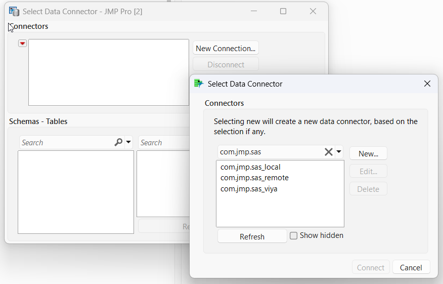

SAS integration
JMP 19 reintroduces the SAS integration that was removed in JMP 18. The new SAS integration uses the SASPy Python module to connect to and interact with SAS. This new SAS integration allows you to connect to SAS Viya and SAS 9.4, either remotely or via local servers to import, sample, and run SQL queries on SAS data. Additionally, users can interact with SAS by submitting SAS code, reading SAS logs, generating ODS HTML5 reports, and importing SAS data into JMP using the GUI or using JSL.
SAS integration is installed on demand upon first use. Connect to SAS with the data connector selector and choosing the base configuration for your desired connection type. Both remote and local SAS connections require Java to be installed on the system per SASpy. Similar to JMP 18, JMP 19 does not install Java.

SAS integration provides three new data connectors to access data tables from SAS: remote, local, and SAS Viya. They can be accessed with the data connector interface. SAS Query Builder supports access to SAS data sets, allowing complex queries to be created in a friendly user interface. To export a data table, open it, go to File>Export..., and select the SAS export option. This opens the SAS Export dialog where you can then choose the export location and other options.

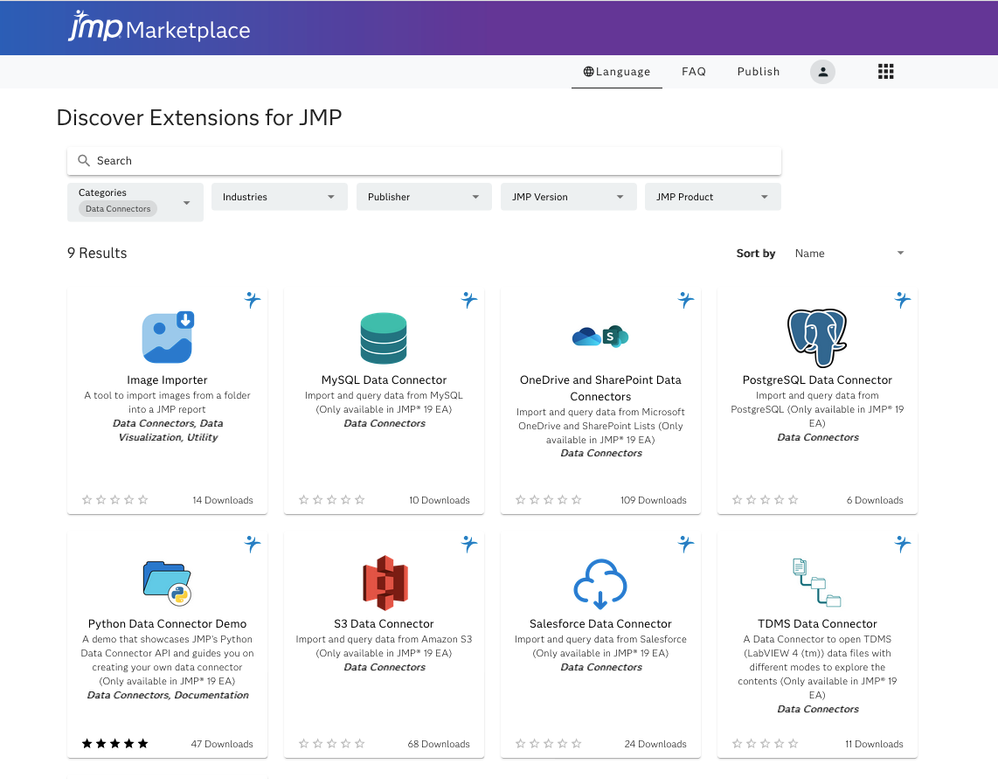

Add-ins
The JMP Marketplace now offers new data connector add-ins that connect even more data sources and resources. The add-ins are built and maintained by JMP staff and members of the JMP Community, so you can customize your experience even further. The specific data connector add-ins require JMP 19 and above.

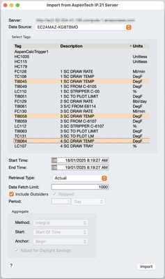

AspenTech IP.21 importer
The AspenTech IP.21 importer enables direct, native access to Aspen InfoPlus.21 (IP.21) historian data within JMP. Modeled after the AVEVA PI Importer, it offers both an interactive import dialog and full JSL support, allowing you to authenticate with your server, browse available data sources, select and filter tags, and define time ranges and retrieval methods. Flexible options such as interpolated or aggregate retrieval and asynchronous import make it easy to bring process data into JMP for time-series analysis, visualization, or integration with other sources, streamlining workflows for industries that rely on IP.21.
