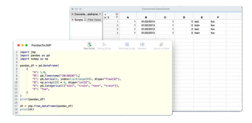

The jmp.from_dataframe() function provides an efficient way to convert external data frames into JMP data tables. The data frame protocol provides the mechanism to convert between data frames in memory. All data frame objects that provide support for the data frame interchange protocol can convert between data frames in memory. Notable examples are pandas, polars, and ibis.
The example below shows a transformation of a pandas data frame into a JMP data table.

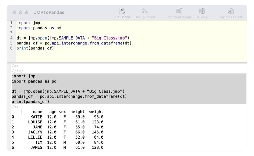

Likewise, it is equally easy to transform JMP data tables into another supported data frame library type. For example, from JMP to pandas:

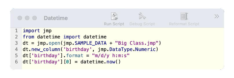

A table’s column format is now accessible using col.format with a string or tuple, depending on the use case. JMP 19 properly marshals between JMP’s date-time representation and Python’s date-time representation: JMP dates in the data table, Python date-time objects from Python code.
Similarly, Python Get()/Python Send() now supports seamless transfer of date-time values between Python and JSL.

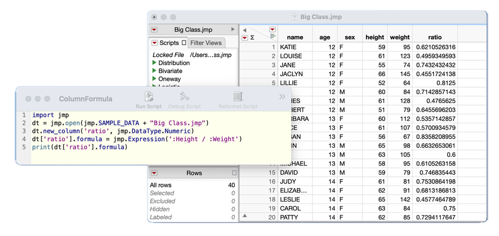

In addition to the ability to format columns, Columns can add formulas as well, using col.formula with jmp.Expressions.

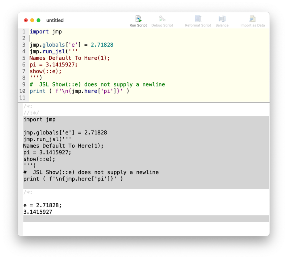

Many workflows still require JSL support to perform specific tasks in JMP. To enhance cross-language workflow, support for adding, reading, and modifying JSL variables from Python has been added. Currently, it is supported only through the Global and Here namespaces. The example below shows Python setting the JSL variable ‘e’ from Python, then using JSL to set the here::pi variable and print the globals ::e variable set from Python, and then finally printing from Python the here::pi variable set from JSL.

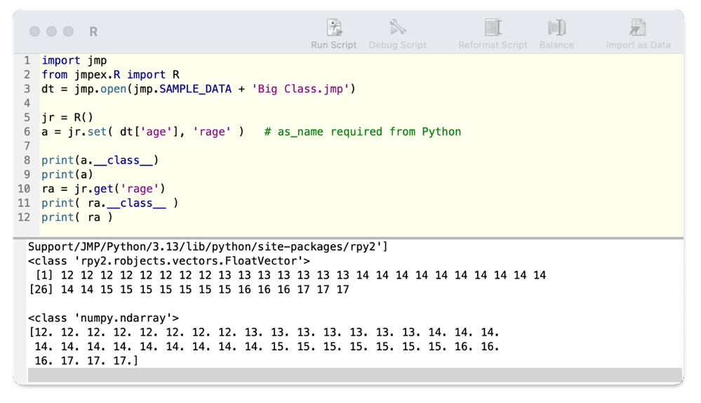

R integration
JMP 19 introduces an initial support for R through Python using rpy2. JMP provides a new module, jmpex, to support extensions. R is the only extension that jmpex currently supports. This support consists of a Python API similar to the JSL R API. The package jmpex is an interface layer between JMP and rpy2, which, in turn, depends on R. A user-installed version of R must already be present on the system, and the R_HOME environment variable must be set to the R location. These must be present before jmpex is installed or R Init() is called for the first time due to jmpex package requirements.
JSL support for R has been restored in JMP 19 by utilizing the jmpex package internally.
The example below illustrates the new Python API to R supplied by jmpex.
