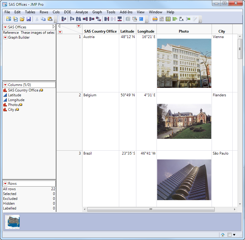

The photo shown in Figure 1 was created from the sample data table shown in Figure 2.
Figure 2 Sample data table with expression column
You can also make the table rows taller as shown in Figure 3.
Figure 3 Resized expression column
