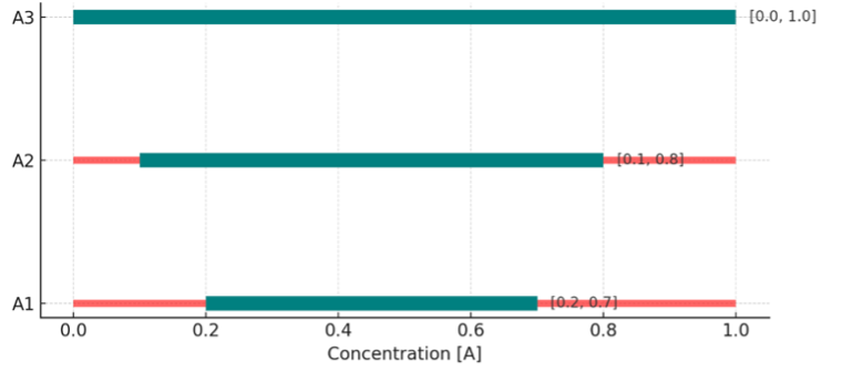

Let’s discuss what we mean by mixture designs with variant-specific constraints. In the example below, we have a mixture of A, B, and C components. Component A, however, can come in three different variants: A1, A2, and A3, with each having its own allowed range of concentration (shown below).
 Figure 1: Allowed (green) vs. disallowed (red) ranges of concentration [A] based on variants A1, A2, and A3.
The desired outcome of the DOE is shown in the ternary plot below where using variant A1, [A] in the DOE has a value between [0.2 – 0.7]; for A2, A=[0.1 – 0.8]; for A3, A=[0 – 1].

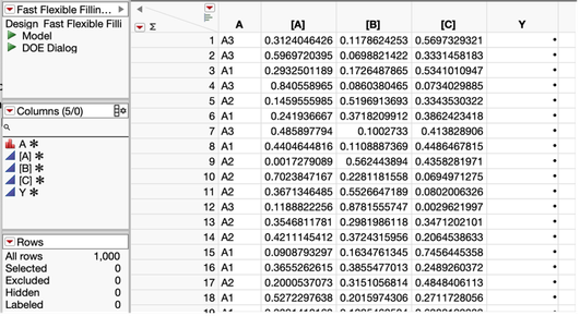

The candidates data table would look similar to the following:
 Figure 5: Fast flexible filling design output data table used as a candidate set of 1000 potential runs.

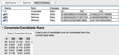

First, go to DOE -> Custom Design. Click "Select Covariate Factors" under Covariate/Candidate Runs.
Figure 7: Outcome when Covariate/Candidate runs column [A], [B], and [C] are added using the Select Covariate Factors button.
