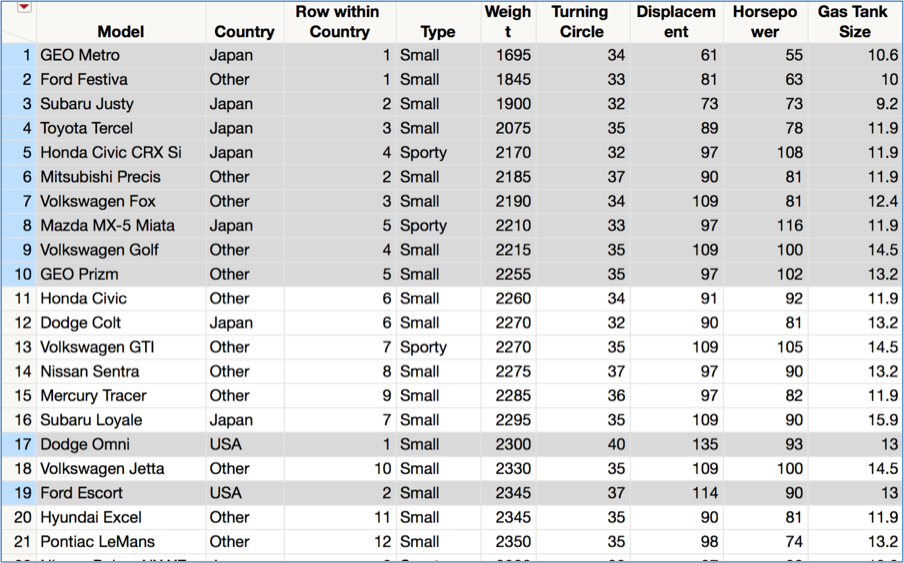

Below, I’ve added a column (highlighted) to compute the cumulative number of cars, grouped by country, that occur in or before the given row. Notice that as we proceed down the rows of the table, the cars with Country = Japan are numbered sequentially, as are the cars for Country = USA and Country = Other.

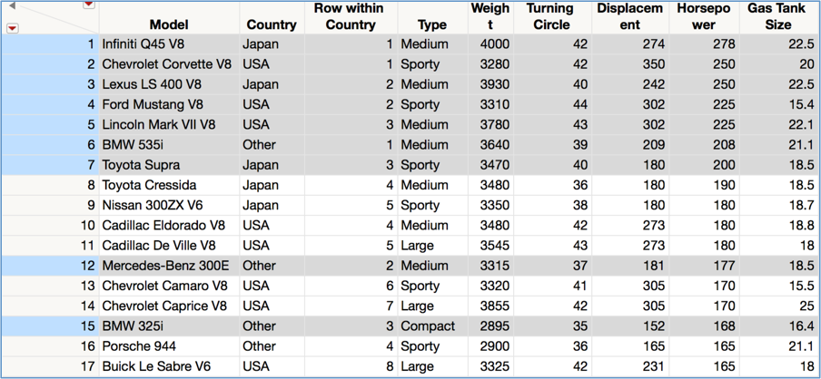

This approach is powerful because to answer the question “which are the five lightest cars in each country?” we must only do the following:
  • Sort the table by Weight, in ascending order, keeping the original table.

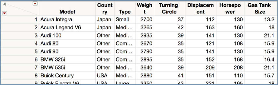

  • Select the cells where the ranking column is <= 5.
  • Subset these rows if desired.
This approach is also flexible because if we decide we now must find the three most powerful cars from each country, we simply sort by Horsepower in descending order and select cells where the ranking is less than or equal to three.

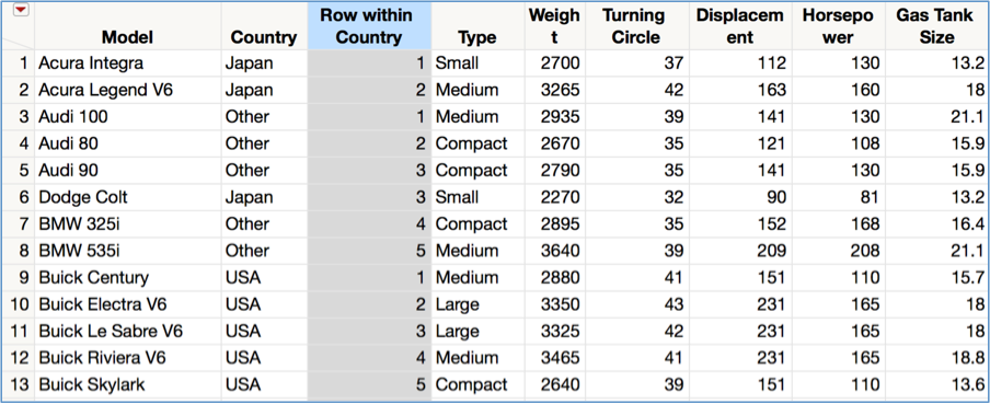

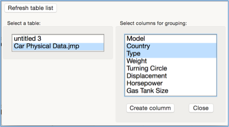

The formula in the ranking column is simple (below), but you don’t have to write it down: Using the Data Table Tools add-in, even non-scripters can easily add a column like this to any table, using any combination of grouping columns.
Once you run the add-in, you just need to select the table and grouping columns you want, and click the "Create column" button. That's it!
