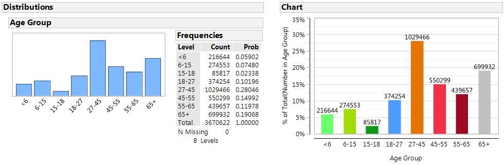

Value Colors for Categorical Variables in Distribution Platform Histograms
For Categorical Variables it would be nice if Histograms in the Distribution Platform (Bar Charts in that case) could have bars with different colors (e.g. determined by Column Property Value Colors). Maybe there could be an option in the Distribution Platform to say "Use Value Colors for Categorical Variables".
At the moment the choice of color affects the entire Histogram. For continuous variables it's probably difficult or even not a good idea to allow Value Colors as bar widths are kind of floating. But for categorical variables I think this would add value. At the moment I use "Chart" in the Graph menu for this, but there I don't get the info of the Distribution Platform, like Frequencies.

Idem for Graph Builder. The color drop zone doesn't add color as it should when distribution grph is selected.

or color by group!

@Sarah-Sylvestre, I agree with Gerd on this matter. I would be a really nice tool to have available.
Is there any updates on this matter?
@gerd have you found a way around this?
hogi
Level XIII
for the histograms in the distribution platform, it's not possible, right?
but for bar charts
.. and histograms in Graph Builder:
