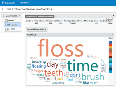

Fully interactive data filters, those that subset the data and produce analytic results on those subsets, need to have a JMP process to reanalyze the subset and produce the results. As such, these will never be supportable in interactive HTML alone. That's why JMP Live was created. To provide a web site that can host interactive JMP reports with data filters and column switchers.
JMP Public is a public-facing version of JMP Live to allow public sharing of JMP reports. If your data and analysis isn't proprietary you can publish it to JMP Public.
As for word clouds, I've published a sample report from the Text Explorer platform with a word cloud and a data filter to show how this works.
JMP Public report with word cloud and data filterJMP Public report with word cloud and data filter
