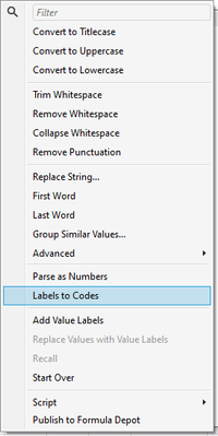

when it could be done with single line (since JMP17):
dt:name << Labels to Codes;
Example of the methods which are difficult to utilize outside of recode are group similar values
And we will end up with Map Value instead of nice "grouping" script
