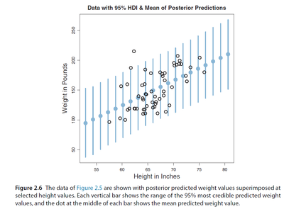

Prediction intervals are useful to judge whether the data generated by the proposed model looks like the actual data, often called a "posterior predictive check" in the Bayesian literature. If the data generated by the model does not resemble the actual data, then it may be desirable to consider a different model. Please see a description of this concept, along with a simple example, from John Kruschke's book "Doing Bayesian Data Analysis" below:
"The fifth step is to check that the model, with its most credible parameter values, actually mimics the data reasonably well. This is called a posterior predictive check... One approach is to plot a summary of predicted data from the model against the actual data... The predicted weight values are summarized by vertical bars that show the range of the 95% most credible predicted weight values. The dot at the middle of each bar shows the mean of the predicted weight values. By visual inspection of the graph, we can see that the actual data appear to be well described by the predicted data. The actual data do not appear to deviate systematically from the trend or band predicted from the model. If the actual data did appear to deviate systematically from the predicted form, then we could contemplate alternative descriptive models. For example, the actual data might appear to have a nonlinear trend. In that case, we could expand the model to include nonlinear trends... We could also examine the distributional properties of the data. For example, if the data appear to have outliers relative to what is predicted by a normal distribution, we could change the model to use a heavy-tailed distribution..."
