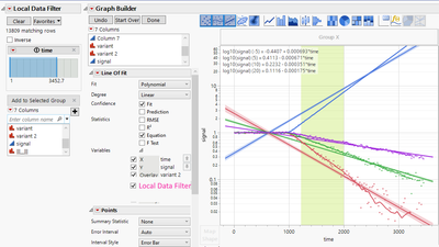

You want to fit an exponential decay - in Graph Builder - and you want to see all the data - not just the values which are used for the fit.
This IS possible - but not with the a click of a button !
What is the improvement you would like to see?
Please add the Local Data Filter to the list of "variables" which can be activated/deactivated for specific plots.
This feature can be used to restrict the fit to the meaningfull range (green) - for point and smoothers, all the data can be displayed.
