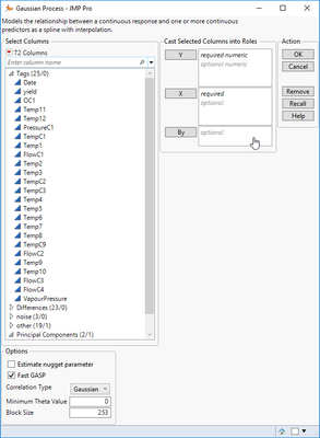

Gaussian Processes are a very powerful modeling technique in predictive analytics.
https://scikit-learn.org/stable/modules/gaussian_process.html
While JMP has GP, it is only for specialized modeling (not possible to fit using training/validation/test)
