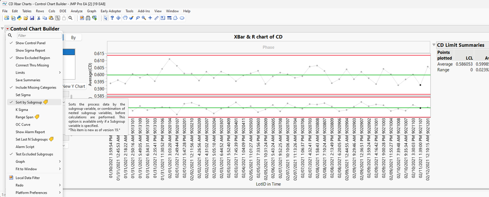

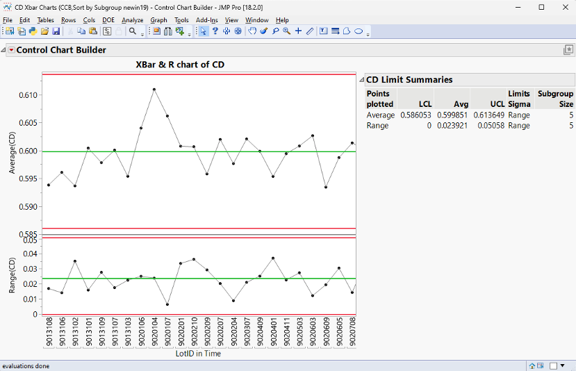

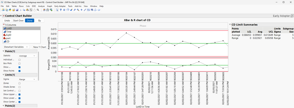

Hello @Vball247 Thanks for your Wishlist item! It turns out that JMP 19 (to be released later this year) will have a red triangle menu option called "Sort by Subgroup" which should address your request (without needing to change the data type or modeling type of the Timestamp column, and without the need to set Value Order as a column Property on a Nominal or Ordinal modeling type for the LotID column).  I'm demonstrating with the EA (early adopter) 8 release version, so this will function the same in the new commercial release once it's ready:

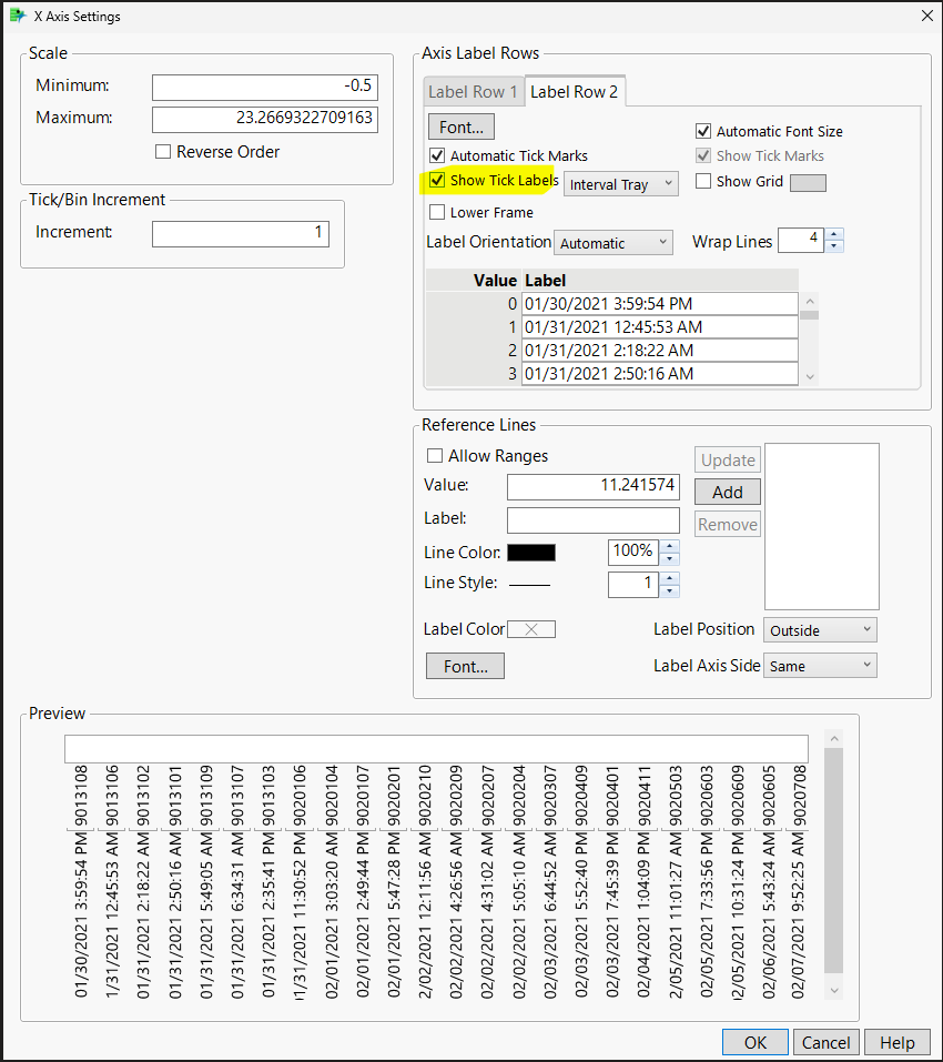

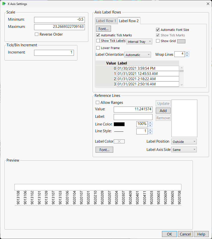

Once you're happy with the chronological order by lot (ordered in time), you can always "turn off" the display on the Time Column, by going into the X Axis Settings and unchecking the "Show Tick Labels" option.
