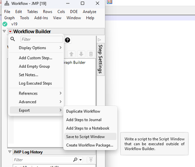

Sounds like "Save to Script window" from the red triangle menu:
Not a button - but the requested functionality.

As @hogi mentions, this capability is provided in the Red Triangle menu. If the functionality isn't meeting your needs, provide some additional information and we can re-open this request.
