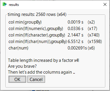

The approach is EXTREMELY slow - if the subset if-condition contains a  string comparison:
How-do-I-use-the-Col-Maximum-Formula-with-a-where/M78599
Then the time scales quadratically with the number of rows and even for small data sets with just a few 1000 entries the calculation takes seconds.
For data sets with some million entries it would take months (!!!) - but will be stopped by a timeout and an error message pops up. Not nice!

timing examples, copied from here
corrected version - in a prev. version the screenshot showed [ms] instead of [s]
