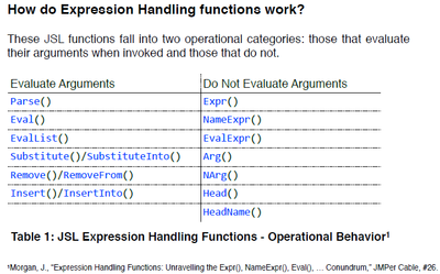

There is a wonderful lecture by @joseph_morgan :  on the differences, how to live with them and how to use them to develop efficient and robust applications.
...  describing the status at that time: Jmp 14 [2018]:
This doesn't exist in the documentation.
This is something I figured out [ ] by reverse engineering the behavior of expression handling functions.
Trust me, [ ] if you do not think of these functions in this you will never get them right.

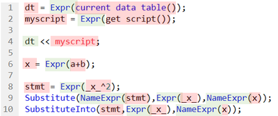

What is the improvement you would like to see?
Please implement some syntax highlighting to indicate the different ways a function evaluates - or doesn't evaluate its arguments.
Add-On: Please also indicate the difference in the Scripting index.
In JSL editor, the highlighting can be activated/deactivated via a keyboard shortcut.
The Expr(_x_^2) show kind of dilemma:
the argument of Expr () doesn't get evaluated. But the two arguments of ^ would get evaluated.
Maybe the highlighting reacts on the position of the mouse or cursor -  just the arguments below the branch are highlighted where the mouse/cursor is currently located.

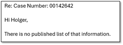

Status now, Jmp18 (2024):
