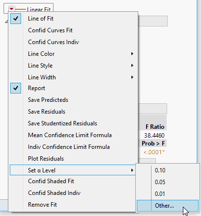

Other platforms provide an option to set the alpha level in the report.
  1. Select Set α Level > Other from the red triangle menu in the report.
  2. In the window that appears, enter a number between 0 and 1 to specify the alpha level.
Confidence IntervalConfidence Interval
