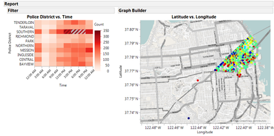

- CellPlotSFCrime.jmpapp
CellPlotSFCrime.jmpappsource
This example includes a Graph Builder heatmap used to filter a Graph Builder point element of crimes in the San Francisco area. Opening the .jmpapp file will run the application, while opening the .jmpappsource file will open the Application Builder to edit the report.

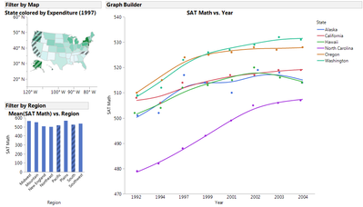

- GBMapFilter.jmpapp
GBMapFilter.jmpappsource
This example uses two reports to filter a single result graph. One filter uses a map representation of the US states, while the other is a bar chart of geographic regions. There is a single Data Filter Source Box surrounding the two filters, which means that they share a selection state. Selections within one filter are linked to the other filter, and can be combined using ctrl+click to extend the selection.

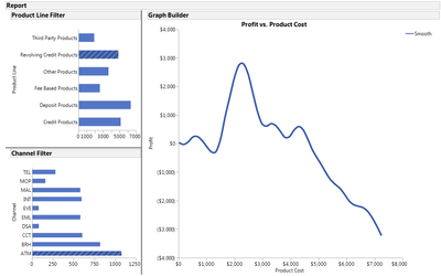

- SalesHierarchy.jmpapp
SalesHierarchy.jmpappsource
In this case two reports are combined to create a hierarchical filter. By using a nested arrangement of two Data Filter Source Boxes, a selection in the first-level filter changes the rows included in both the second-level filter as well as the final report. Selections in the second-level filter result in the final report updating to include only the cross section of the selections in the two filters.
