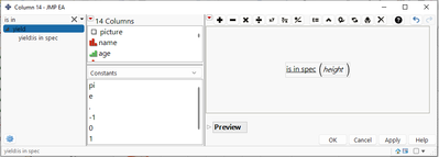

Thanks @Georg for taking the time to show different approaches to calculate is in spec in JMP. I feel very honoured : )
I just tried a dynamic version of the approach with some locally defined lsl and usl values. Please decide on your own - with the additional As constant() it is much faster, but the values don't get updated. Without the As Constant() it's slower, but the user has the chance to update the column via
cols = Current Data Table( ) << Get Selected Columns;
for each({col}, cols, col << eval formula())

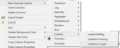

use case: a new column with a formula to generate 0/1 values for out-of-spec/in-spec values.
If there is a typo in the specs, or the user wants to adjust the spec, the values of the column should automatically update (should not stay stuck with the old settings).
maybe for 10-30 columns.
100k - 10Mio rows.
A solution which can easily be shared with new colleagues who want to use JMP to analyze pass/fail information.
