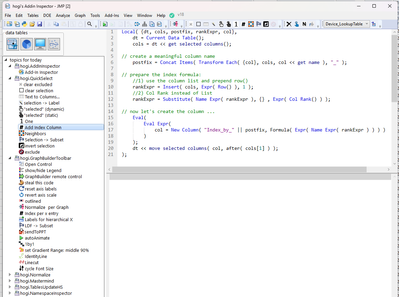

To use the  AddIn_Inspector, just download and install the attached file.
In line 28, you can list the AddIns you want to look at:
If the AddIn is installed in the system, it will show up in the Tree Structure on the left of the GUI:
To install an AddIn, please download it from the Marketplace:
