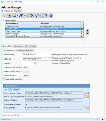

AddIns -
Besides the standard "AddIn Builder" which is included in JMP, one can (SHOULD!!!)  use
Add-In Manager     @Justin_Chilton  -> now via the Marketplace: Add-In Manager
https://community.jmp.com/t5/Learn-JMP-Events/Scripters-Club-Managing-Your-JMP-Add-Ins-with-Justin-C...
New in JMP19: the update check which is directly included in JMP.
In previous versions, one could set up a similar functionality via UpdateCheck.jsl (from AddIn Manager).
Did somebody compare the speed of the 2 approaches?
e.g. for 40 AddIn update checks via UpdateCheck vs. the new Functionality?
Does the new function compare the file date - or some content?

I created my own update scripting based on the update stuff Justin originally included and haven't tested side by side with the new methods in 19. I will say that it may be faster via JMPs methods given they are looking at a source folder for an updated file, while Justin's methods (at least the ones I use) may lag depending on where the metdata master files live. From the couple times I've been prompted by JMP to udpate an addin in jmp19, it 'feels' as fast as what I already have implemented.
Since the new methods in 19 seem to basically be looking for new files in a location and not be tied to any builddate metatdata, while I like this approach in general, there is no real control on what constituts a 'source folder' ... for instance, if i drag an addin in from my downloads folder and it asks if i want to check for updates, it will list the downloads folder as the source to be checking. In addition, it doesn't separate between what may be prod vs test versions of an addin, and the "source" folder couldbe incorrect if a user checks for updates, but it was a test version installed from a different location.

@nathan-clark from what I see with JMP19's add-in builder, it is not quite like that. Unfortunately I don't have time at the moment to fully document my experience, but I'll quickly outline what I have. I am not an expert though. My goal was to fully replicate my old shared drive version, but in a different area using the JMP19 method.
Create an add-in using file->new->add in.
Set up the add-in by adding your scripts / icons. For mine, these are on a shared drive.
Have it automatically update files (in include files tab), and check for updates when JMP starts in General tab.
Save as to create a new .jmpaddin in an accessible location. Leave it there and have others install from that location.
Other JMP users will install from that location and their version of JMP will check that location to detect changes.
When you want to edit any files, open up the add-in builder / jmpaddin file so you are seeing the add in editor. then make your edits to the script. Then the 'save' button should appear visible in the add-in builder.  Or use save as and save the addin with the same name.  If you just drop an updated script file, or edit the jsl file and close it, and then later open the add-in builder, you won't see the save option. This  a bug that has been reported to the developer.
JMP users using older versions of JMP will need to update the add-in by reinstalling the .jmpaddin file. JMP19 users should be prompted to update the add-in if they installed it from the same location. I don't know what happens if we go emailing the .jmpaddin file... presumably JMP wouldn't know where to later check for updates.

That makes sense @mikedriscoll. Unfortunately, that relies on JMPs implemenation of addin creation. I have way too many addins for that and now that we have them all managed via github, those mehods aren't scalable which is why I've requested the codifying of specifics in the addin.def file.
I think JMP19 is making some good strides for addin management, but long term more options need to be in place for the scale various people / organizations reach with addin management. And with a few updates from JMP, I believe I can start deprecating some of my current addin update infrastructure.
